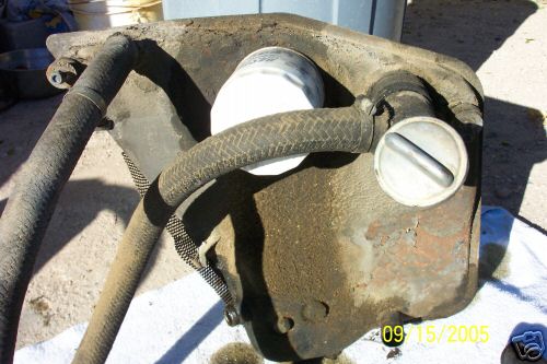

I'm gonna use a 911 oiltank in my six conversion (it's out of a 3.2 carrera)
Today, I cleaned up the tank and ground off the stock mounting tabs (which are on the "front" of the tank, thus useless)
(IMG:http://www.914world.com/bbs2/uploads/blog-1133643274.jpg)
Next, I fabbed 2 new mounting tabs
(IMG:http://www.914world.com/bbs2/uploads/blog-1133643284.jpg)
And welded them to the tank
(IMG:http://www.914world.com/bbs2/uploads/blog-1133643294.jpg)
Tank roughly in place against the firewall in the front trunk
(IMG:http://www.914world.com/bbs2/uploads/blog-1133643306.jpg)
(IMG:http://www.914world.com/bbs2/uploads/blog-1133643322.jpg)
Nice thing about the 911 oiltank is that it has a drainplug
I took out one of the "donuts" in the front truck floor and the drain will be positioned over it
I used some pvc plumbing pieces from the hardware store to cover the hole up and still keep it easily accessible
(IMG:http://www.914world.com/bbs2/uploads/blog-1133643342.jpg)
Another nice feature on the 911 tank is the sender for a oil level gauge
I still need to make a mounting tab near the bottom of the tank and the tabs on the chassis, but so far, it's working out nicely
