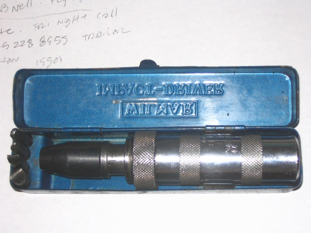

Get an impact driver from the hardware store. It's got a screwdriver bit and you hit it with a hammer. As you hit it, it twists. They take a little getting used to using, but they work great for exactly what you're asking about. One moderate hit and it'll at least get the thing started and hopefully it doens't twist the head off. (IMG:http://www.914world.com/bbs2/html/emoticons/ohmy.gif)

Mark is right on PU one of these at HF bout $10 I use it all the time
