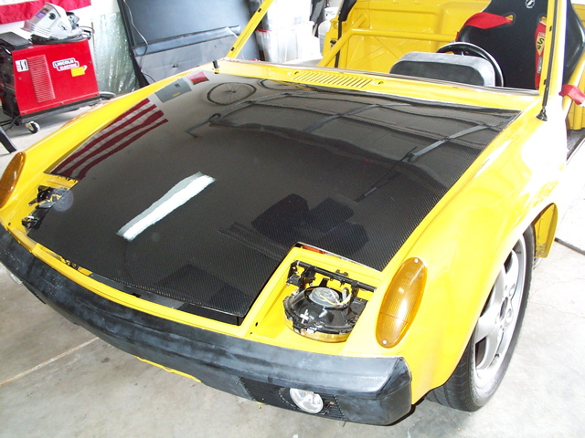

Here are your decks when they arrived here:
Series9
post Dec 5 2005, 12:44 PM
Lesbians taste like chicken.
Posts: 5,453
Joined: 22-August 04
From: DeLand, FL
Member No.: 2,602
last:

Thanks for the pics....
It looks like the front lid is way too short up front?? Hopefully what I am seeing is a lack of a trim piece or something because that gap up front is huge. As with any 914 project, maybe this hood project will be more involved that I planned! (IMG:http://www.914world.com/bbs2/html/emoticons/dry.gif)
So the holes in the front, are they for the pins? The holes are soooo big I wanted to check on what you actually had in mind to fill them with. Good chance this front hood may get a fibreglass hole fill (x4), edges sealed, then painted to match the body. Hopefully I can fill the holes with some chrome pins or plugs...
Thanks in advance for any info or advice. (IMG:http://www.914world.com/bbs2/html/emoticons/beerchug.gif)

With all the glass front hoods you'll need to cut and reweld the front bulkhead. I think it's 46mm or something like that.
They didn't tell you?
(or it could be that the hood is proped up a bit in the picture) (IMG:http://www.914world.com/bbs2/html/emoticons/laugh.gif)

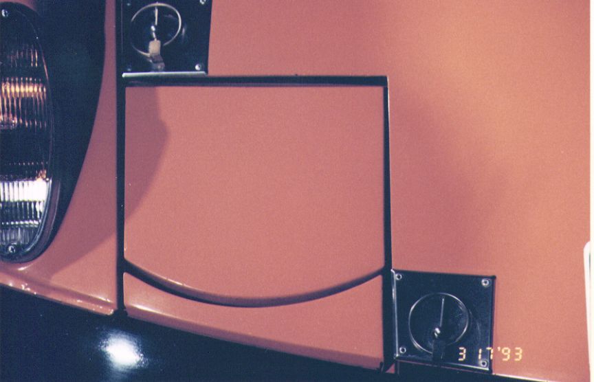

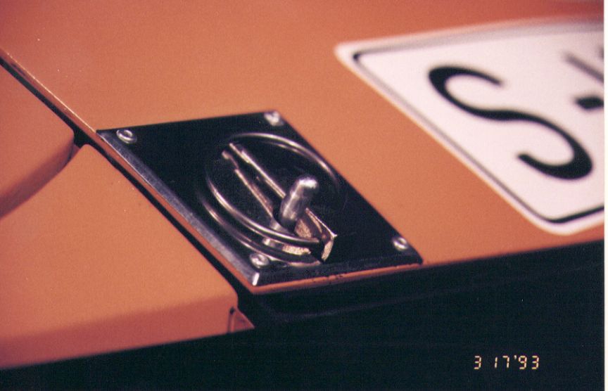

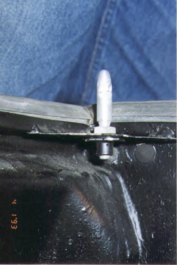

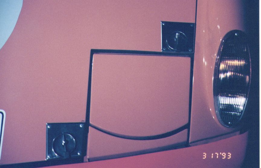

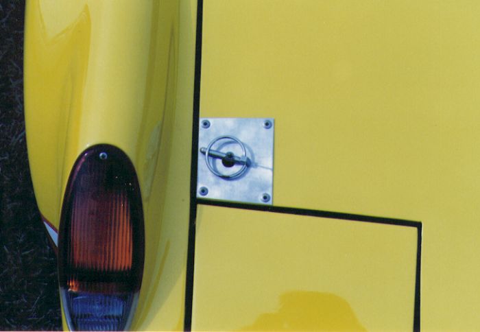

Now for the real answer.
I got pins at Pegasus. You'll probably have to fabricate the plates out of sheet aluminum. Let me know if you need some templates.
E.

You mentioned in another post that you were looking at the hood pin locations shots...
Eric_Shea
post Dec 5 2005, 09:10 PM
PMB Performance
Posts: 19,304
Joined: 3-September 03
From: Salt Lake City, UT
Member No.: 1,110
more...
Eric_Shea
post Dec 5 2005, 09:11 PM
PMB Performance
Posts: 19,304
Member No.: 1,110
more...
Eric_Shea
post Dec 5 2005, 09:12 PM
PMB Performance
Posts: 19,304
Member No.: 1,110
more...
Eric_Shea
post Dec 5 2005, 09:13 PM
PMB Performance
Posts: 19,304
Member No.: 1,110
more...
Eric_Shea
post Dec 5 2005, 09:14 PM
PMB Performance
Posts: 19,304
Member No.: 1,110
more...
