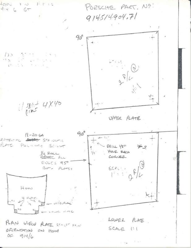

BUT, rather than patch the holes someone (maybe it was you!) drilled in the front lid I might actually put in the hood pins. The idea I guess was to go for the 914 GT look with the pins in the hood. After doing the famous Search on 914 Garage, I can't seem to locate a source, or even a decent picture, of the 914 GT front hood pins. Acutally, there is another 914 GT web page, Armando's (spelling?), that shows the backing plates and some hardware, but not the top view of the finished look.
Anybody know a good source for nice looking pins to fill the approx. 1/2 inch dia. holes (4) in the front of this hood? Any pictures of finished options would be awesome too!

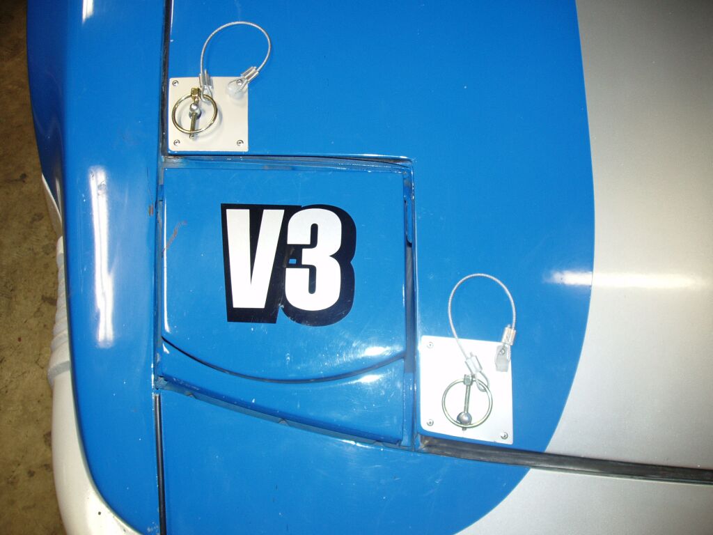

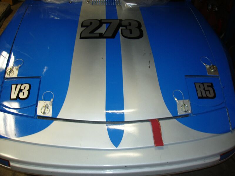

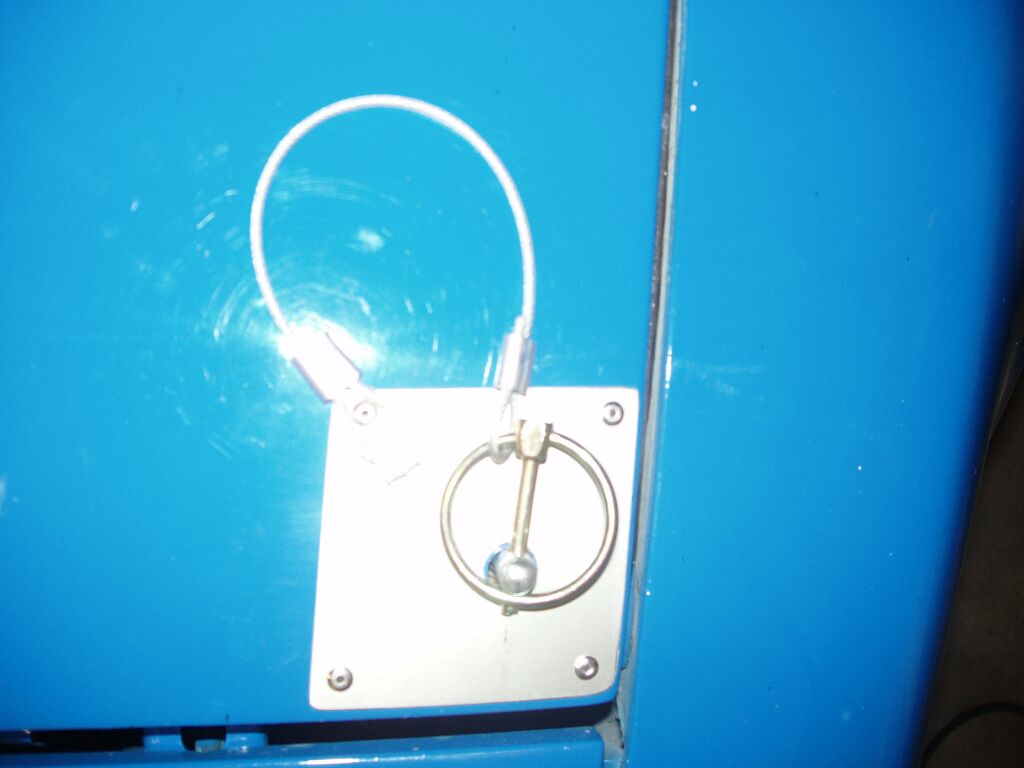

Series9   I drilled the holes. http://w...   Dec 5 2005, 12:40 PM
Series9   Here are your decks when they arrived here:   Dec 5 2005, 12:44 PM
Series9   last:   Dec 5 2005, 12:44 PM

drew365   Mine don't look too different from the others ...   Dec 5 2005, 09:45 PM
drew365   Closer;   Dec 5 2005, 09:47 PM
drew365   Closest;   Dec 5 2005, 09:48 PM
Eric_Shea   this might help... got it from somebody here I thi...   Dec 5 2005, 10:16 PM

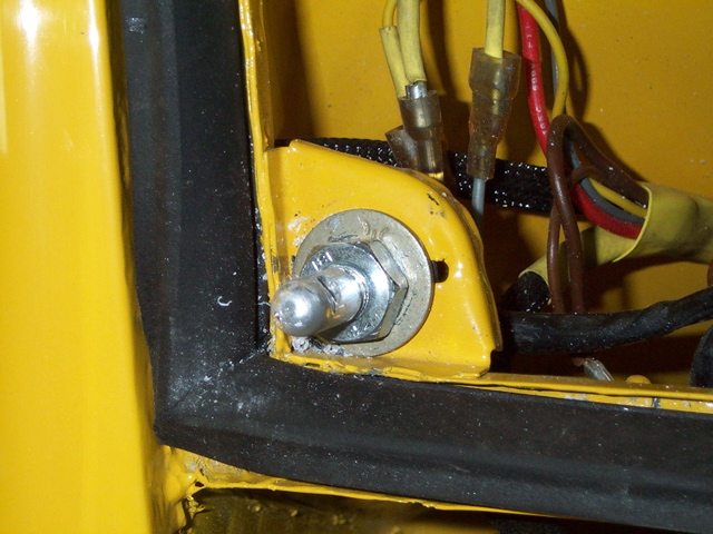

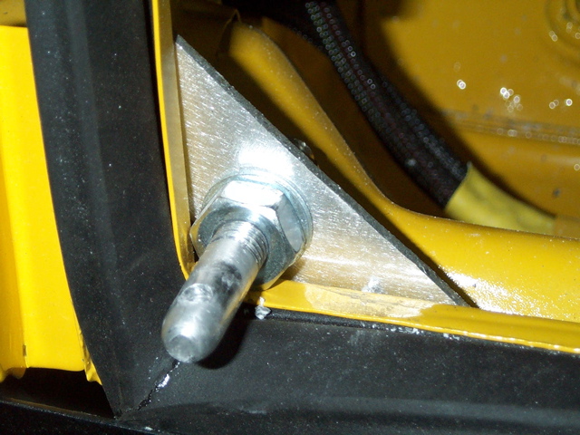

Series9   My scuff plates look just like all the pics above....   Dec 5 2005, 10:23 PM
Series9   and:   Dec 5 2005, 10:24 PM
