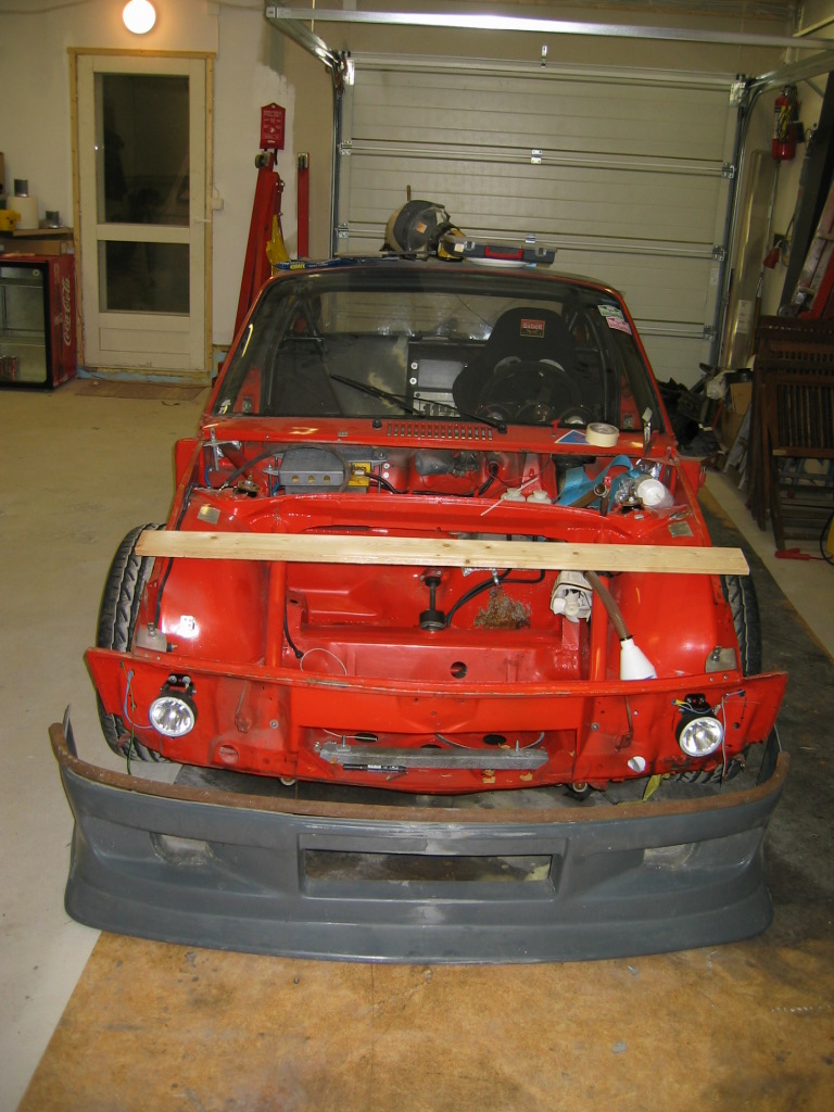

I had to make it public. That's the only way i'am going to get anything done.
So, i had to convert my rear suspension to multi link, raise the front suspension, built a new pedalbox, rebuilt the engine and tranny, make attachemets for new fg flared rear and front fenders, make a new carbon top, glue the new heated windshield, paint the car and lots of other stuff.
I will post pictures when ever i have any progress.
Here is the starting point

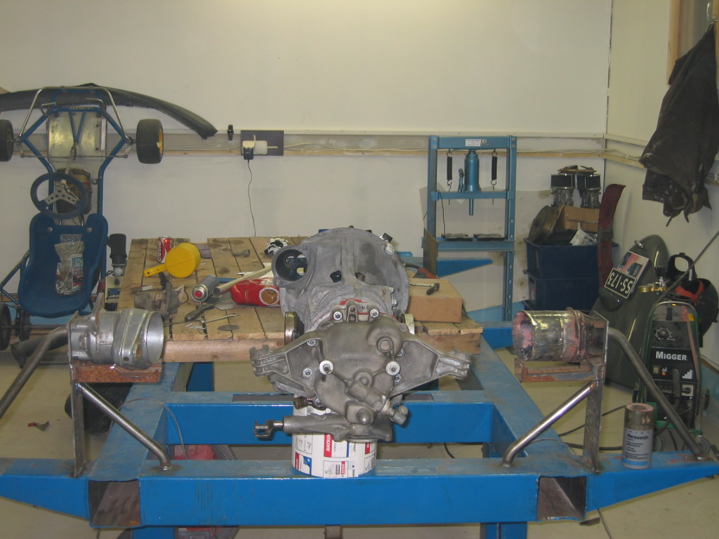

hub's are attached to table
(IMG:http://www.914world.com/bbs2/uploads_offsite/fvwa.sitefactory.fi-179-1274375881.2.jpg)
lower part of the new front
