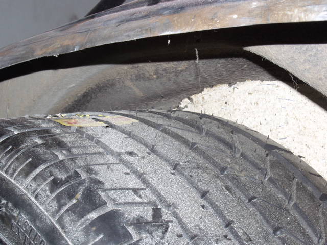

here's what it looks like at the ride height that I plan on using.

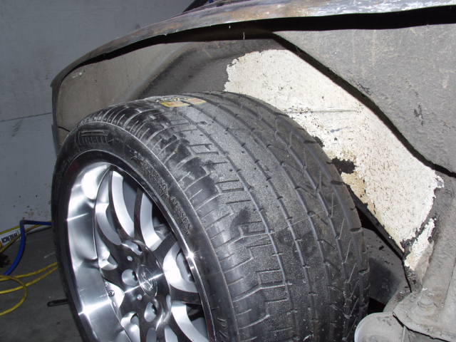

Here it is with the suspension bottomed out (well the shocks anyway).

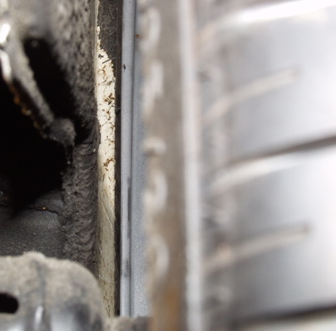

Here's a shot from behind. Still seeing some light.

That looks okay to me. What is that, about 3/4" gap (in the shock bottomed possition)? Nice wheel/tire combo. (IMG:http://www.914world.com/bbs2/html/emoticons/drooley.gif)

3/4" is what was left.

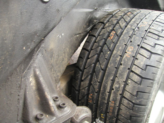

Felix I'll see if I can make. What do you plan on getting there?
Is that pic of your car?
That looks alot less clearance than mine.
