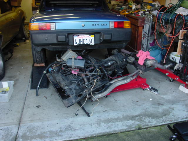

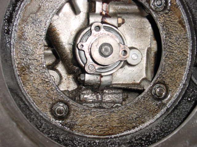

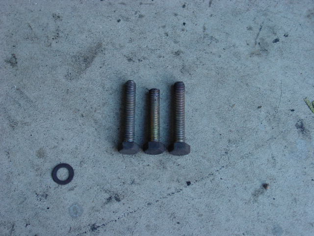

Finally got to drop the 2.0 out of my '75' today. Followed Mark D's instructions in the tech article and was able to remove it by myself. Great instructions, thanks Mark. Had to drop it because 2 of the bolts in the fan had worked their wat out and the 3rd sheared off. I don't know how I got so lucky but, the fan came through undamaged. The only issue is that there is about a 1/4" of the 3rd stud broken off in the gland on the front of the crank. I tried pulling that gland but it's really on there so, I thought I'd ask for advice from the group. Here's a couple of pictures.

Got a dremel? grind a slot in the bolt for a flathead screwdriver and pull it out???

I would remove the bolt, remove the flange....
Bring it over to the vise, and drill out the bolt, then clean the threads with a tap....
Take a few bolts out...get all the normally used taps...
The taps for the engine tin
for the head studs (exhaust studs)
You will eventually need them all.
Use heat...then drill...you may get it to loosen up with heat and the drill to a point that it twists out.

drill a pilot hole...
drill a larger hole.
EZ out it....

QUOTE (rjkavanagh @ Dec 31 2005, 06:45 PM)
Pic 2
That piece is not in there very tight, you could take a small chisel and tap it loose, you'd be surprised. You will probally have to replace the hub, it looks like it ripped out the alignment pin, and check the small hole in the fan, it might of messed up wen the bolt snaped.

The hub might be really stuck to the crank. You can use an inexpensive harmonic balancer puller from your FLAPS to pop it off.

Try a counter clockwise (left) drill bit @ 1/8" , by the time your almost through the bolt usually come out on the bit.

use a boron bit to drill a easyout with. super hard bits

LH bits are the way to go for drilling broken bolts. Half the time the bolt will back out before you drill all the way through.
Whenever possible you should use a smoke wrench and warm up things first. DO NOT USE A TORCH ANYWHERE NEAR THE HUB WHEN IT'S STILL ON THE CRANKSHAFT!!!
