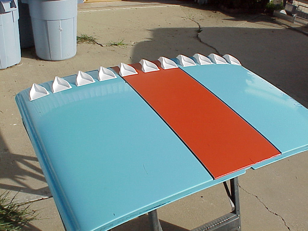

Received my airtabs today and just set them on to mockup the spacing.
Plan is to paint to match the top & stripe.
Going to test with this first before lifting the top.

QUOTE (race914 @ Jan 10 2006, 03:15 PM)
shouldn't they be mounted 180 deg. rotated?
(IMG:http://www.914world.com/bbs2/html/emoticons/huh.gif) Andy

QUOTE (SirAndy @ Jan 10 2006, 03:48 PM)
Hi Andy,
I thought so too at first. Good thing I read the directions from the manufacturer www.airtab.com
Here is their diagram of the concept of operation
TimT
post Jan 10 2006, 06:08 PM
Post #66
retired
Posts: 4,033
Joined: 18-February 03
From: Wantagh, NY
Member No.: 313
No those are mounted in the correct direction.

Any results, or opinions on the Vortex generators after mounted?

QUOTE (retrotech @ Mar 3 2006, 09:08 PM)
Will be going to Buttonwillow in April
Good test for me because I'm in 5th on the 'riverside' turn and the rear end has always been light and dances around.
I'll report my results.
I saw a mention in the 'Phoenix Track Day' thread that Wayne Baker was there and commented on the vortex generators and something about 'stable at 160'. I'm hoping to be stable at 130!

Any pictures of them mounted? Painted to match yet?

Hey Racer914!
Don't forget that your leaving really bad turbulence behind you, too. That could make it really hard your someone to follow you down the straight.
Just seeing if I can help with some strategy....

QUOTE (alpha434 @ Mar 4 2006, 08:01 AM)
Hey Racer914!
I Love it!
I need to add that to my bag of tricks.
Actually the rear end twitching around keeps people back now through that turn!

QUOTE (retrotech @ Mar 4 2006, 07:51 AM)
Where can I find that info from Wayne baker?
It was in the Vintage Racing: HSR West thread.
1st page. Response by Greg Robbins
"Wayne is running a four that he told me puts out 165 hp. Running a SCAT balanced crank, Cam (he wouldn't say which one), euro pistons, and 44mm Webers. I am sure he is running high compression as he runs race fuel. He's not a six, but he sure is fast.
I asked him about the airfoils on the back of his targa top. He said they don't do anything and smiled. Said they were on the car when he got it. Then he added there is no way to test if they work or not. Told me the car had run 160+ at Daytona and was very stable. Many find the cars get light on the rear at 130+. HSR does not allow spoilers or wings which is why you don't see them on any of the cars."

QUOTE (retrotech @ Mar 4 2006, 08:51 AM)
Me.
I met and visited with him at the HSR West event at Phoenix. I asked him about the vortex tabs on the roof of his car. He told me he didn't know if they worked or not, then smiled. He added that he didn't know of any "scientific" test to prove that they worked or not. Then added the car ran 160 at Daytona and was stable.
Can it do 160? Not sure, but it is one "kick butt" 914 and Wayne is one hell of a driver.
gregrobbins
post Mar 5 2006, 10:29 PM
Post #78
Member: Team NARP
Posts: 1,515
Joined: 23-March 04
From: Arizona
Member No.: 1,844
I sent an email to the company who makes Airtabs. I got a reply from the inventor, Gary.
I had a llittle 914 back in 1971 so am quite familiar with it.  Airtabs
should be mounted across the trailing edge of the roofline.  That
vertical rear window type of "step", results in Airtabs increasing the
turn angle of the main flow, so more mass-flow hits the trunk deck
spoiler.
He'll be very lucky if they're accepted as legal.  Sanctioning bodies
are usually notoriously against things like vortex generators.  For
example, I had a very bad time with NHRA over them - when installed on
the world-record-holding Top Fuel Funny Car.
They lived to regret it because I definately got my revenge and old
timers still talk about it to this day.  But that's another story for
another time.
Gary

So the company basically confirmed that If your rules say: "no modifications for the purpose of Aerodynamics"
then you would be cheating to use these.
imagine that.
