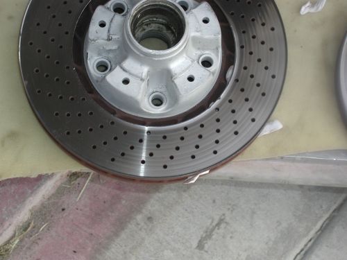

OK so I have these 993 rotors laying around and figure I can put them on my car and have some great brakes. I have a pair of 911 struts and hubs coming from the west coast but figured I would get a jump on this with the extra hubs I won on EBAY. That way if I mess up I can just get some carrera rotors and use regular good brakes. I have been looking at some of the 911 guys brake conversions on the bird board. The hubs need to fit down inside of these rotors but need to be modified so they will go in.

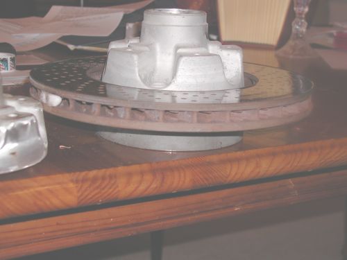

This is the lip that I must remove

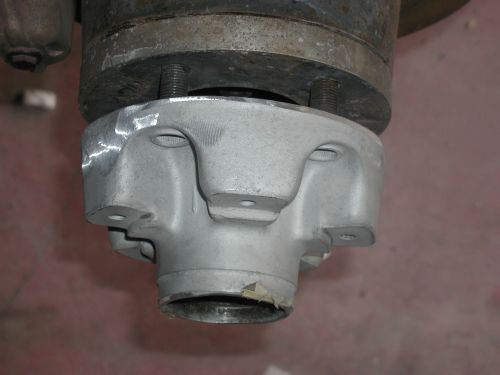

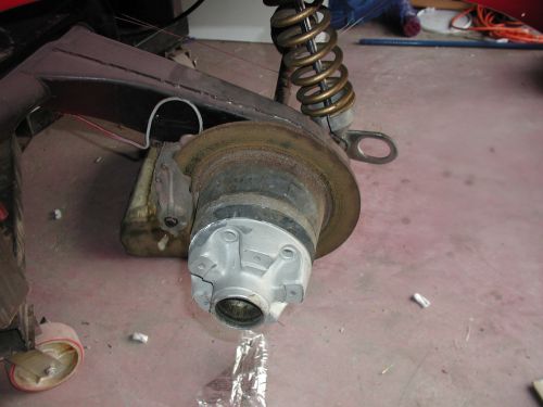

I dont have a lathe here at the house and there is a new guy over in plant maint who is watching guys to see who is doing home projects (IMG:http://www.914world.com/bbs2/html/emoticons/unsure.gif) So I figured out if I put them on the rear axel studs I could spin the axel and use a die grinder to remove the extra lip (IMG:http://www.914world.com/bbs2/html/emoticons/cool_shades.gif)

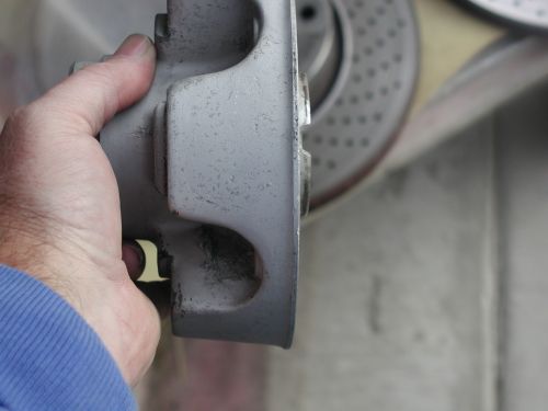

Here is after a couple of minutes but my boy got tired of spinning the axel (IMG:http://www.914world.com/bbs2/html/emoticons/laugh.gif)

(IMG:http://www.914world.com/bbs2/html/emoticons/aktion035.gif) I got it almost down in to the rotor but had to stop to watch the rose bowl. Will post more photos tomorow (IMG:http://www.914world.com/bbs2/html/emoticons/beerchug.gif) I plan to make my own adapters for the front calipers once the struts get here. Then the next chalenge will be the rear rotors and brakes.

just a thought.... how unbalanced is the hub now?
albeit its all close to the center (less effect....)
spare time toys
post Jan 4 2006, 07:57 PM
hooked on grilling food.
Posts: 4,059
Joined: 3-April 04
From: West Plano Tx
Member No.: 1,884
QUOTE (Aaron Cox @ Jan 4 2006, 08:26 PM)
I will almsot guarentee these hubs are not balanced at the factory. The hubs on our riding mower look like more effort was put into making them (IMG:http://www.914world.com/bbs2/html/emoticons/sad.gif) These had flashing on them left over from when they were made (IMG:http://www.914world.com/bbs2/html/emoticons/screwy.gif)

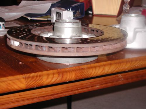

More work on making this work today (IMG:http://www.914world.com/bbs2/html/emoticons/smile.gif) I got it in and sitting flush (IMG:http://www.914world.com/bbs2/html/emoticons/smilie_pokal.gif)

This is as close as the pre worked hub gets (IMG:http://www.914world.com/bbs2/html/emoticons/sad.gif)

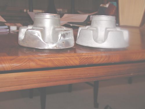

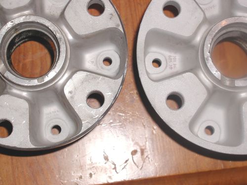

this is a side by side comparison of the hubs

here is up close of the face end of the hub where the rotor goes up against. It is not as thin as it looks because you need to cut a 45 Deg. chamfer on the edge because down in the rotor it is not a square corner from the side to the face. (IMG:http://www.914world.com/bbs2/html/emoticons/idea.gif) I would guess they do that because of stress.

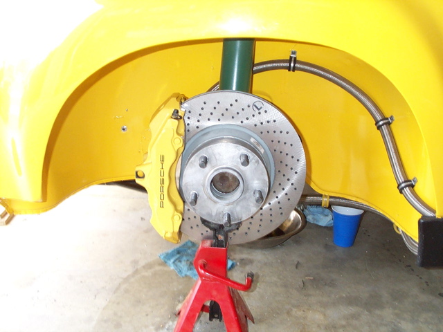

I turned mine on a lathe to fit 996TT rotors. Unfortunately for me, the 6-piston Brembos I used didn't lend themselves to machining adapters, so I had to fully commit by cutting and welding substantial mounting blocks.
You're on the right track.

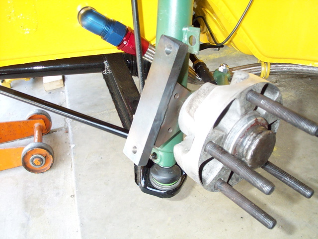

another:

gawdamn.... 100mm studs?

Oh yeah!
The adapters you need are available from Steve Timmins in Delaware. He's the one who first started using the late style rotors on early hubs.
http://www.instant-g.com/
Series9
post Jan 5 2006, 07:06 PM
Lesbians taste like chicken.
Posts: 5,453
Joined: 22-August 04
From: DeLand, FL
Member No.: 2,602
QUOTE (Aaron Cox @ Jan 5 2006, 06:02 PM)
Yes.

joe....thats a PCCB caliper, right? are you using the composite pads?? because thats not the composite rotor...or did you just paint the big red brakes, yellow
