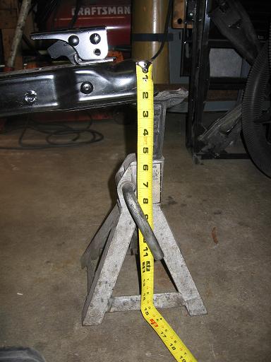

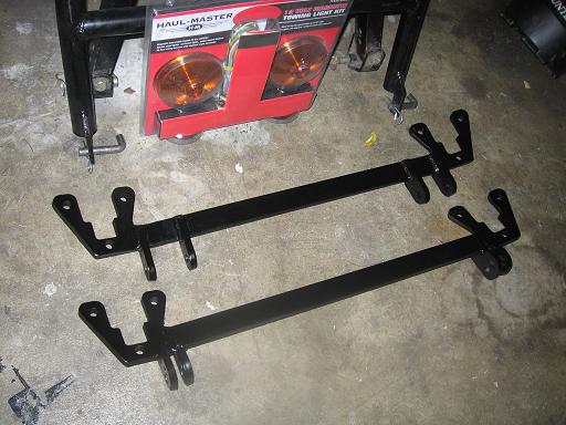

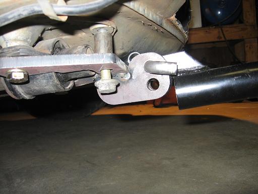

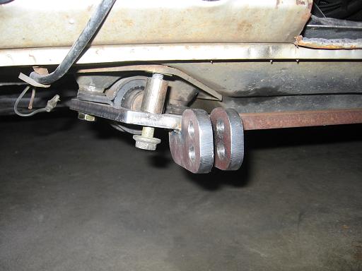

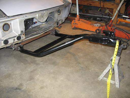

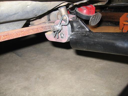

dlee1967   Here are a few pics of the design and mock up. RE...   Jan 23 2006, 09:45 AM
dlee1967   another   Jan 23 2006, 09:46 AM
dlee1967   last   Jan 23 2006, 09:46 AM
jimkelly   Looks good - exactly what I was looking for. As f...   Jan 23 2006, 10:08 AM

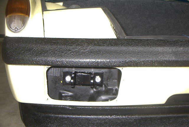

andys   Couple of pic's of how I id mine. I tied into ...   Jan 23 2006, 11:00 AM
Dan (Almaden Valley)   David, That looks great. Exactly what I had envis...   Jan 23 2006, 11:17 AM
jimkelly   that is very robust but intrusive? David has foun...   Jan 23 2006, 11:35 AM
dlee1967   Dan, I am going to get the bar attachment point as...   Jan 23 2006, 11:48 AM

dlee1967   Dan, the yellow line is where the new tabs will re...   Jan 23 2006, 12:10 PM

Dan (Almaden Valley)   David, I was pretty sure that the notch would add ...   Jan 23 2006, 12:15 PM
dlee1967   Matt, you can't flip the SB tow bar over. It ...   Jan 23 2006, 12:19 PM
dlee1967   Dan, I've noticed your two references about tr...   Jan 23 2006, 12:21 PM

dlee1967   Last post for today as I need to get some work don...   Jan 23 2006, 12:43 PM

dlee1967   That's it......well.....sort of. If I have a...   Jan 23 2006, 06:52 PM
plas76targa   David, that latest drawing looks good. Look forwa...   Jan 23 2006, 07:55 PM

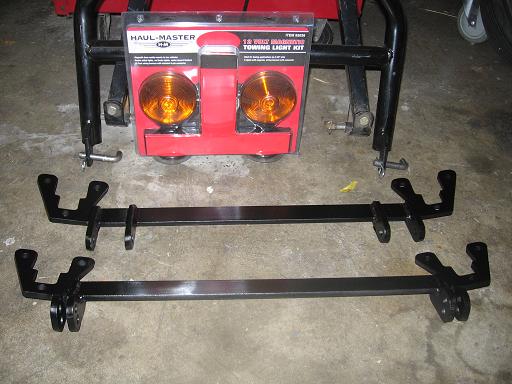

plas76targa   Found some photo's from last summer's trip...   Jan 23 2006, 08:09 PM
plas76targa   here are the magnetic light's under the sail p...   Jan 23 2006, 08:12 PM

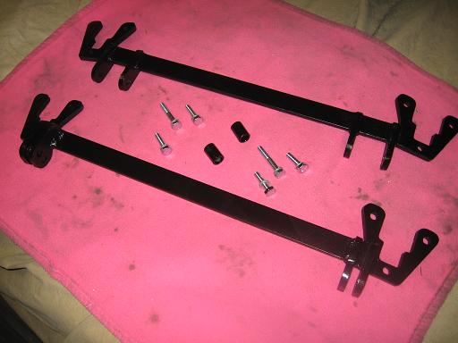

dlee1967   Parts are cut. I will be making a welding fixture...   Jan 27 2006, 04:32 PM

dlee1967   I now have the weldment for the DrawTite style tow...   Jan 27 2006, 05:05 PM

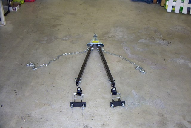

Gint   Here's one: Draw Tite tow bar on ebay Draw T...   Jan 28 2006, 05:52 PM
Gint   So you can see what a new unit would cost: Draw T...   Jan 28 2006, 06:07 PM
dlee1967   That's the one! It uses 1/2" pins and has...   Jan 28 2006, 06:09 PM
