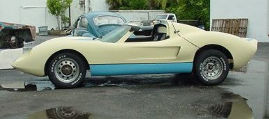

This may help you a bit. A company called FaberFab makes/made several VW based kit cars that used a tilting device on the rear quarters for access to the engine. One was the Aztec GT, pictured below, another was the Avenger. Here's a link to the FiberFab web site:
http://members.shaw.ca/thefiberfabcars/ Attached image(s)
