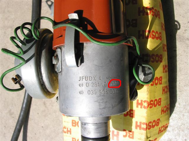

Hey Guys,
Here's an up close look with #'s on a Bosch 050 Distributor. Hope that helps.
Tom

QUOTE (Thomas J Bliznik @ Jan 18 2006, 10:35 AM)
Hey Guys,
Tom
that's an 009... (IMG:http://www.914world.com/bbs2/html/emoticons/bootyshake.gif)

QUOTE (tat2dphreak @ Jan 18 2006, 07:52 AM)
Hey Guys,
Tom
And it's NOT the $50 009 they're talking about, either. The Cap'n

QUOTE (tat2dphreak @ Jan 18 2006, 08:52 AM)
Hey Guys,
Tom
werd

see the 009 ????
what distinguishes the good one from the bad?

That picture and part number is for a stock 1.8L distributor. The 009 that is sold aftermarket does NOT have a vacuum advance on it.
It's real easy to get confused. The part number for the 1.8L distributor ends in 009, but it's not the 009 that we refer to when we talk about the "float test".

That image is VW and prolly a 2L bus
0 231 174 009 = VW 039 905 205
It is interchangeable with..
0 231 174 011 which was used on the VW 2L and the Porsche 2L = 039 905 205A
The 009 fitted to the 1.8L Porsche
08/73 to 07/74 ....Bosch Part# 0 231 181 009 = VW 022 905 205 AA
(interchangeable with 0 231 168 005 = VW 021 905 205 P
08/74 up .............Bosch Part # 0 231 176 048 = VW 021 905 205 AB
And of the 009/050 Centrifugals..there is the good one (German) and the shitty one (Brazilian). I'm not gonna look for the Bosch part number on these.
