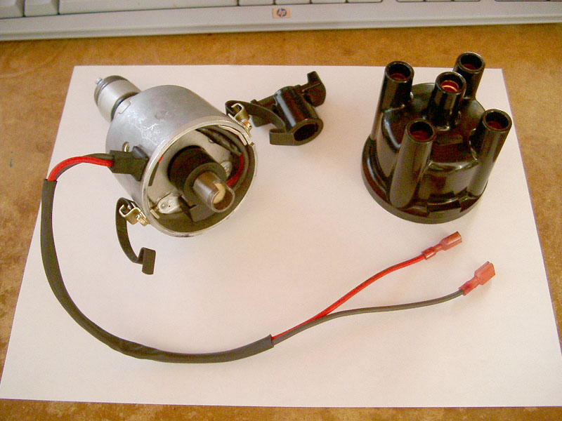

QUOTE (Carlitos Way @ Jan 18 2006, 12:07 AM)
Can anybody tell me the difference between these two distributors? do they use the same cap/rotor?
050 with pertronix ...

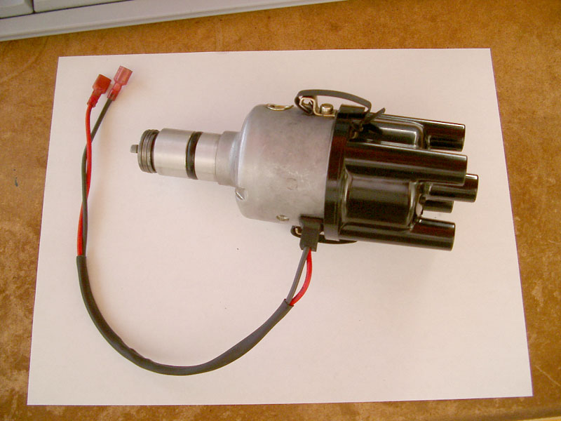

nuther ...

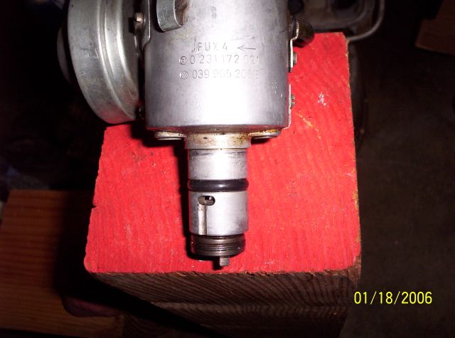

Heres a pic of my d-jet dizzy. Removed from my '73 914-2.0.
JFUX4
0 231172 021
039 905 205B
