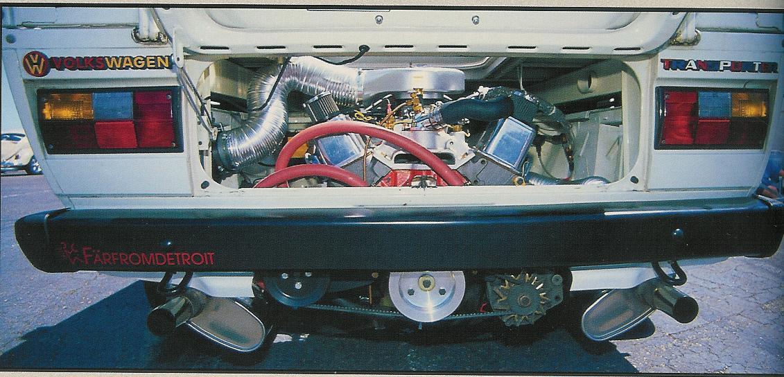

I use the 4D on the 350 LT1 in this VW Transporter. It is ez to tune (by the book).
I do suggest using a fuel pump kill, as the Holley "Clear/ flood" mode on the TPI is finicky and doesn't always allow good hot restarts. A momentary switch as stated eliminates that problem. It was priced about equal to a 750 cfm 4bbl Holley, and fell right on top of the Edelbrock Vic-jr. manifold (IMG:http://www.914world.com/bbs2/html/emoticons/biggrin.gif)
I'm also using the Bosch fuel inj. pump instead of the Holley unit. The tech advised that the Holleys would cause erratic running in time.

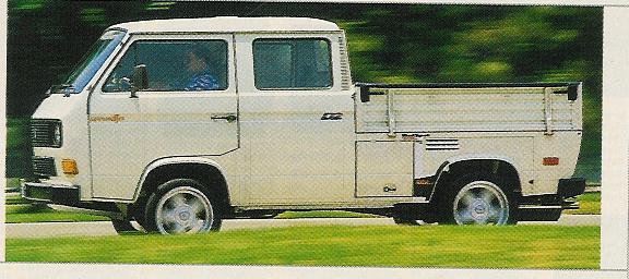

(IMG:http://www.914world.com/bbs2/html/emoticons/ohmy.gif) Whoah baby. Cannot resist the hijack... Marty, do you have a link to a web page or more photos or anything on that Transporter? Cool.

Rand, here's another. I need to scan all of my German8ter build pictures and post them . Do you think that the OT Patrol will be offended by this non-914 content ?
