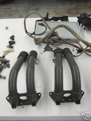

This is a "'73 1.7L L-jet setup" i'm considering buying. I see a 4 bolt pattern, however my carbed 2.0 has a 3 bolt pattern. Can these injection runners be drilled to fit my heads?

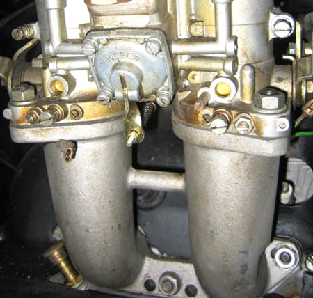

my present setup
were these weber bases drilled for a 3 bolt intake or did they come with a total of 5 holes?

The manifolds under the carbs came with both sets of holes.
As for the fuel injection, that is not a L-jet system, it's a d-jet system. It looks like a 1.7, which will be a bit small for a 2.0. You should get a 2.0 system for best stock performance.

1.7 liter only had d-jet.
it looks like it could be d-jet, but I cant see all the parts from that pic.
If its ljet, just drill out the manifold for the three bolt head pattern, it will be fine.

yep. one size fits all on that design for the carb intakes. i wonder what the little electrical connection on the runner is for? (IMG:http://www.914world.com/bbs2/html/emoticons/unsure.gif)

Yes you guys are correct. It is a D-jet system, my mistake.
I'm building a megasquirt system and want to use some stock components for now just to get things going. So will this stock D-jet 1.7 setup bolt to my 2.0 heads assuming i drill an extra hole in the middle?

r_towle

yes it will work.
I would however question the size of the plenum and intake runners for a 2.0 liter...
