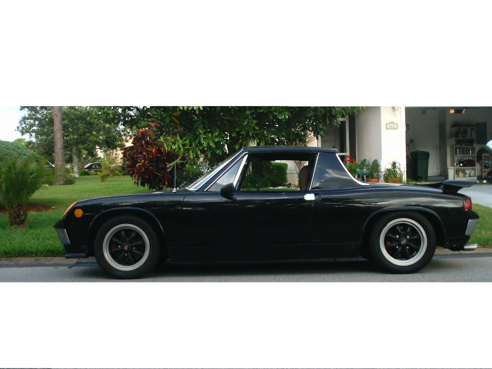

got pics?

Here are some pics. I'm waiting on some engine pics : ( sorry
having some problems with the pic.

pic1 oops, sorry thats huge on the webpage (IMG:http://www.914world.com/bbs2/html/emoticons/unsure.gif) just try this http://www.photospace.co.za/anadeau

Link doesn't work for me.
