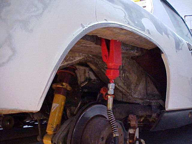

Here's how I stretched the fenders to the limit.
Port-a-Power!
I cut a 2x4 with the same profile of the inside of the fender and used hydrolic power to bring the fender lip to 11.25" from the inner fender well.
Check this out. (IMG:http://www.914world.com/bbs2/html/emoticons/unsure.gif)

how much did the inner fender deflect?
neat idea.

Do you heat the fenders as you stretch them?

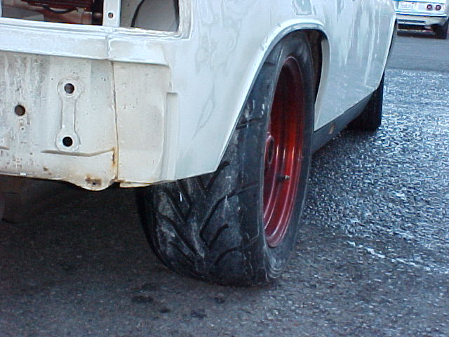

I put a 4x8 along the length of the inner. It didn't seem to deflect at all.
Also hammer and dollied the fender lip flat.

Interesting use of hydraulics...jaws of life (IMG:http://www.914world.com/bbs2/html/emoticons/laugh.gif)
Did you get any unwanted ripples in the quarter panel after the streeeeetch?

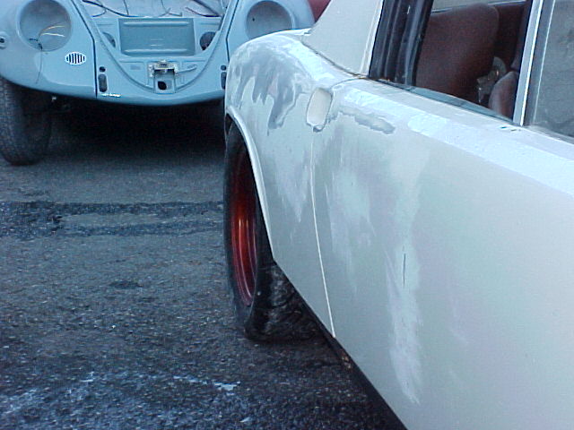

I was very happy with the results. One of the fasteners that connects to the rocker panel made a pop noise! (IMG:http://www.914world.com/bbs2/html/emoticons/ohmy.gif)
It shouldn't need to much hammer work at all. The profile looks pretty natural to me.
No heat used.
KT

Looks good from that last pic. Profile looks about what I had on my 914-6 that I could run 225s on 7s with no problems at all. (IMG:http://www.914world.com/bbs2/html/emoticons/biggrin.gif)

It looks like alot of tire under there. (IMG:http://www.914world.com/bbs2/html/emoticons/ph34r.gif)

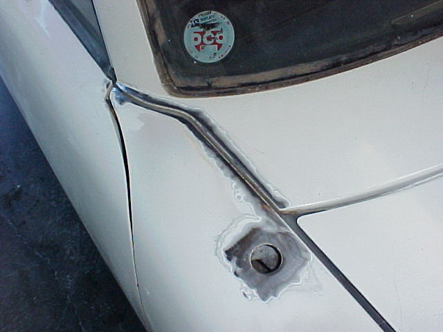

I filled the channels between the front fenders and the flat section below the winshield.
Heres the channel and antenna hole prepped.

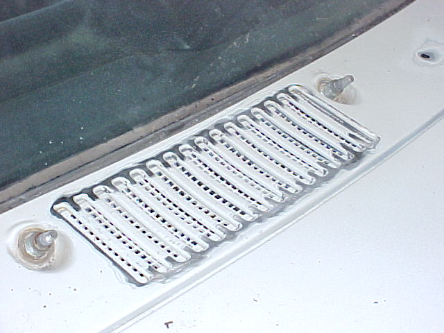

Grille below windshield hammered lower and prepped. (IMG:http://www.914world.com/bbs2/html/emoticons/ohmy.gif)
