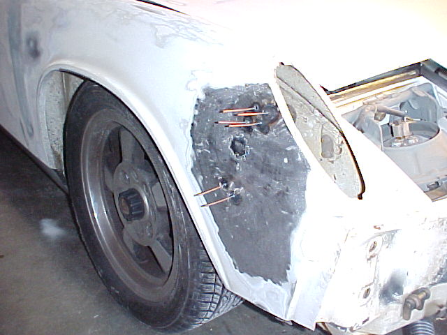

Here's the grille welded...ready for body filler. (IMG:http://www.914world.com/bbs2/html/emoticons/smash.gif)
Trek,
Did you pound down the vent and weld a piece of sheetmetal on top or cut it out first? Looking good! (IMG:http://www.914world.com/bbs2/html/emoticons/biggrin.gif)

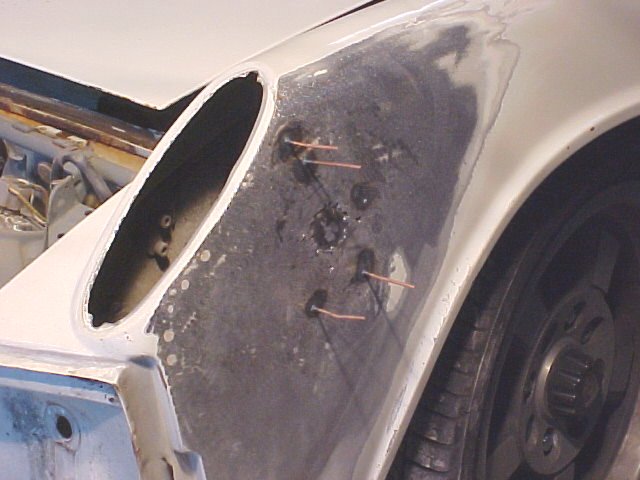

I welded the sheetmetal over the grill after I depressed it slightly. (IMG:http://www.914world.com/bbs2/html/emoticons/smash.gif)
After making a paper template for fitment, I made the patch out of 18gauge.
I spent a good amount of time using the air powered jitterbug sanding board with 36 grit to get most of this side rough prepped. (IMG:http://www.914world.com/bbs2/html/emoticons/w00t1.gif)

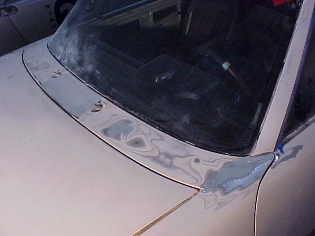

Here's a shot I swiped from Andy's SIX thread.
KT

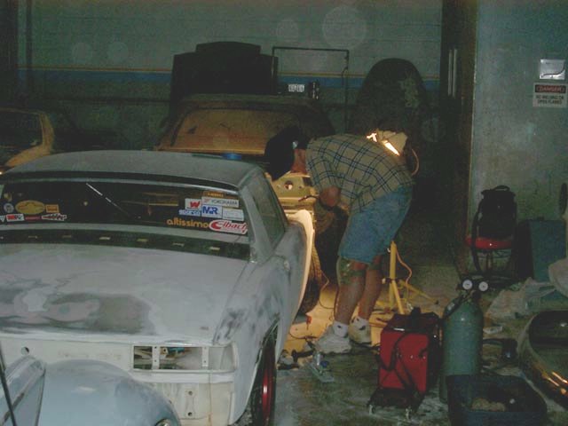

progess-

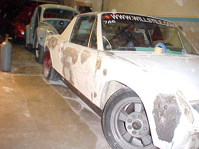

studs tacked on, passenger-
Trekkor
post Jan 23 2006, 04:55 PM
Post #99
I do things...
Posts: 7,809
Joined: 2-December 03
From: Napa, Ca
Member No.: 1,413
studs, driver's-
