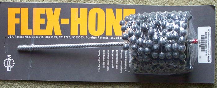

I assume I will need to replace the rings. What is the proper grit hone to use? This one is a 240 grit.

You used a ball hone with 240 grit and hastings rings....

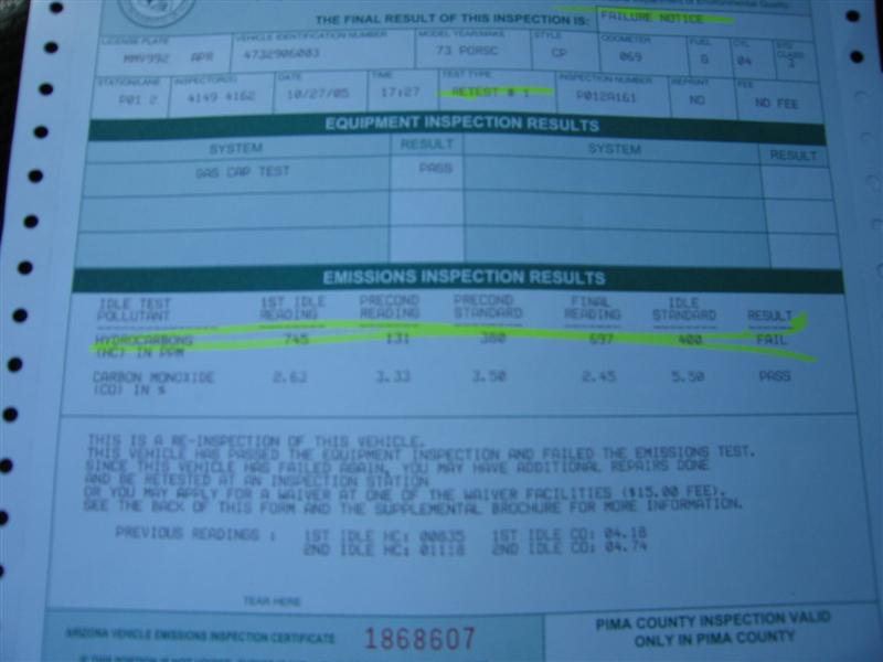

I had some ignition problems that caused high HC readings. Had a bad ground that was limiting the voltage to my coil. Didn't think my CO readings were ever high enough to cause a problem.

I haven't honed my cylinders. Just want to know what to use to break the glaze. Shouldn't take much honing to get them ready for another set of rings. Is 240 grit to coarse?

Yeah at least a 320 or finer. Modern rings don't a high RA to seat quickly. I know guys using a 400 stone to finish.
