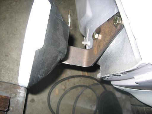

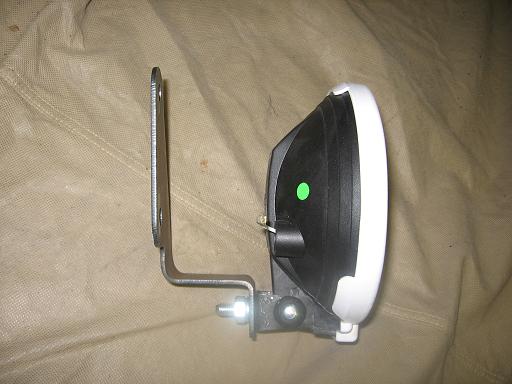

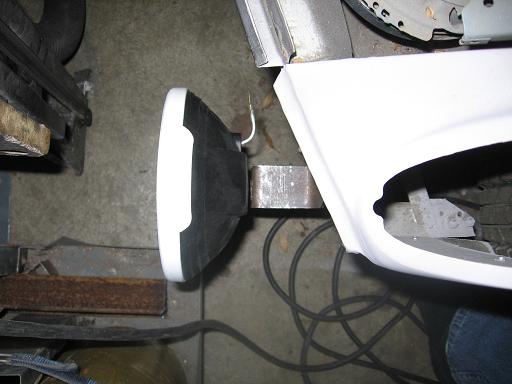

post Feb 14 2006, 12:18 AM
Post #31
V8Lurker
Posts: 540
Joined: 20-February 03
From: Splendora, TX
Member No.: 327
Getting close. I cut two units for test fit. These work well with my stock valance, special edition spoiler and my ultimate air dam. The bumper on this car is a fiberglass unit similar to a stock steel bumper, but I will not be able to try with a stock unit until next week.
These brackets mount under the stock bumper "dog bones" and are reversable so that you may mount the Hella 500s on the far outside of your bumper or closer to your stock "fog light" location. My test units will determine if welded gussets are needed, but at this time, I think not.
Still a few weeks away from production as I am finishing up some other projects, but at least there is a peek. Beta test units to go out next week .........
