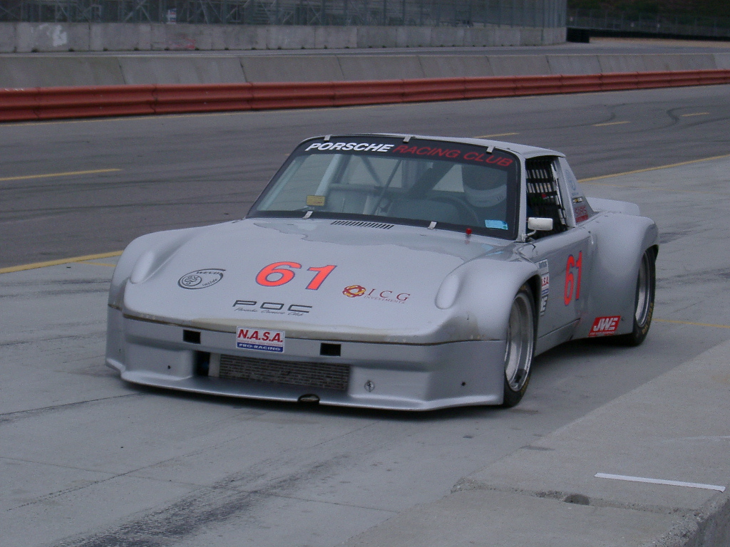

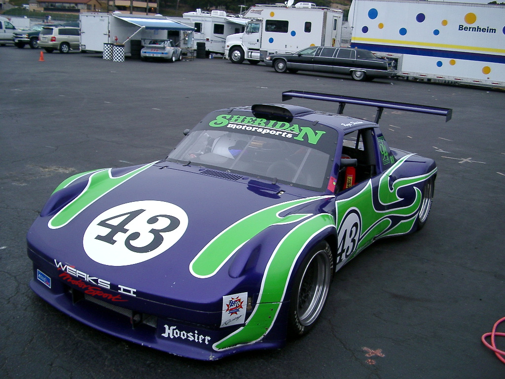

thanks Andy - I have the Sheridan body kit on the car. Right now my 8-1/2" wheels are somewhat deep dish, so the tire is right at the fender, but I have a couple inches to grow toward the inner fender before I hit it or the trailing arm...
post Feb 2 2006, 09:38 PM
Resident German
Posts: 42,535
Joined: 21-January 03
From: Oakland, Kalifornia
Member No.: 179
QUOTE (byndbad914 @ Feb 2 2006, 07:17 PM)
aha, schweet! narrow or widebody? roger's stuff is top notch!
(IMG:http://www.914world.com/bbs2/html/emoticons/smilie_pokal.gif) Andy
roger's own car at laguna last year ... (IMG:http://www.914world.com/bbs2/html/emoticons/wub.gif)
post Feb 2 2006, 09:39 PM
Resident German
Posts: 42,535
Member No.: 179
and scott's car with the same kit at the same event ... (IMG:http://www.914world.com/bbs2/html/emoticons/driving.gif)
