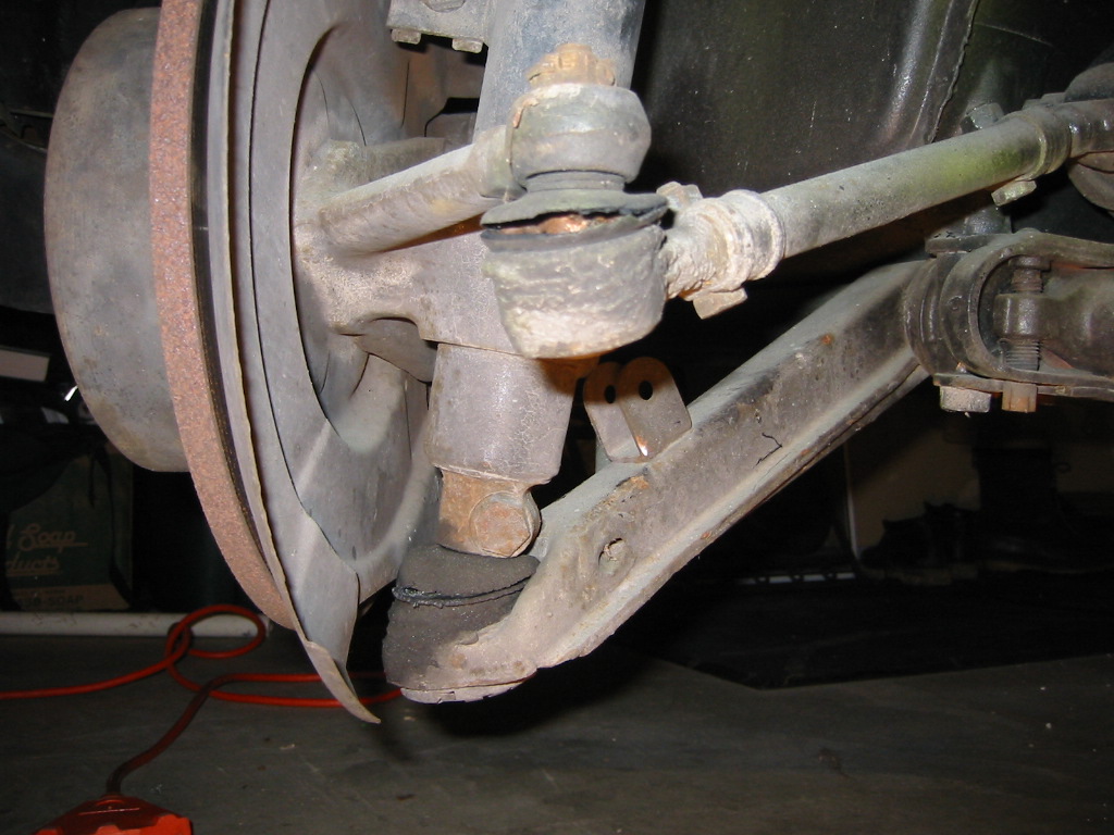

Hey all,
After finally getting back to the states I had a chance to start going through my To Do list for the teener. Well that list just got allot longer (IMG:http://www.914world.com/bbs2/html/emoticons/headbang.gif)
THe whole front end is shot and will need a bunch of work.
Anyone willing to discuss options? Replace what's there or swap out the front end? Also any tips on dropping the front end? I figure that it's easier to work on the suspension when it's out from under the car.
So 2 ball joints 2 tierod ends and struts at a minimum.
Yikes

mike_the_man   Ball joints and tie rods aren't too tought. A...   Feb 3 2006, 08:00 AM

Dr Evil   Hey Neighbor, I may have some spare good parts for...   Feb 3 2006, 10:36 AM
Dr Evil   I see a problem in your future http...   Feb 3 2006, 10:43 AM
Eric_Shea     Feb 3 2006, 11:02 AM
Eric_Shea   Forgot... by all means, attach a sway bar to those...   Feb 3 2006, 11:04 AM
Dr Evil   Eric, Picture one shows the head of a bolt and mor...   Feb 3 2006, 11:19 AM
Dr Evil   Nevermind about what I said abou thte rotors, I ju...   Feb 3 2006, 11:23 AM
mack914   I would scrape the whole thing and put a 911 front...   Feb 3 2006, 11:25 AM

Mueller   I'm pretty much doing exactly what Eric recomm...   Feb 3 2006, 12:12 PM

Dr Evil   911 would be nice, I did it, but then you would ne...   Feb 3 2006, 03:14 PM
rhodyguy   a bumpsteer kit of you plan on lowering it, cheap....   Feb 3 2006, 03:33 PM

Eric_Shea   DaveP... Did we ever figure out that strut/calipe...   Feb 3 2006, 07:38 PM
Dr Evil   Damnit Bevis, Iffn ya can sees a bolt head then t...   Feb 3 2006, 08:15 PM
Dr Evil   Oh, on the rotors. Pelican et al, sells different ...   Feb 3 2006, 08:16 PM
Mar7ck   My 78 911 front end powder coated, sized welt bush...   Feb 3 2006, 09:02 PM
Cloudbuster   Eric / Mike, According to my set of early struts,...   Feb 3 2006, 09:27 PM
Dr Evil   Mark, are you and Eric in legue to drive me nuts ...   Feb 3 2006, 09:37 PM

Dr Evil   Eric, you can http://www.914...   Feb 3 2006, 09:56 PM
Eric_Shea   Next... It's "bacteriophage recombinant DNA" ...   Feb 3 2006, 09:59 PM
Cloudbuster   Looking from the theoretical top (or bottom) of th...   Feb 3 2006, 10:03 PM

Jaiden   Guys Settle. I put more pics in my blog Both si...   Feb 4 2006, 01:31 PM
Eric_Shea   the 911 is virtually identical in layout. You...   Feb 4 2006, 01:47 PM
Dr Evil   Don't forget the bigger better brake option fo...   Feb 4 2006, 01:57 PM
Dr Evil   Jaiden, Is that your front end in the pic? Already...   Feb 4 2006, 01:58 PM
Eric_Shea   OK... we'll give you that one (on some 911 fro...   Feb 4 2006, 01:59 PM
Dr Evil   Not getting cranky yet. I have had my tea, and hav...   Feb 4 2006, 02:03 PM

Jaiden   Yup, That's mine. It took about 2.5 hours to ...   Feb 4 2006, 06:43 PM
