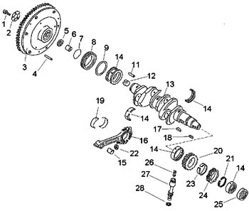

QUOTE (Dr Evil @ Apr 3 2006, 08:48 PM)
Um, NO! The only thing like that is the shim that goes under the bolt heads when putting the flywheel on.
ahh.... now i remember right.... i was in my parts bin and found a bunch of the 5 bolt pattern washer things....

They are not for leak protection, they are to set the play of your crank shaft. If you are missing them that is a bad thing, but I bet they are there and hard to remove.
They are #9 in this pic.

QUOTE (Dr Evil @ Apr 3 2006, 08:56 PM)
i was referring to part 2 in my erroneus statement (IMG:http://www.914world.com/bbs2/html/emoticons/wink.gif)

Take a magnet and put it where the arrows point. They should come out as I believe they are magnetic. Just store them and remember to put them back. Also, you will need new flywheel bolts as they are a one use only type of thing.

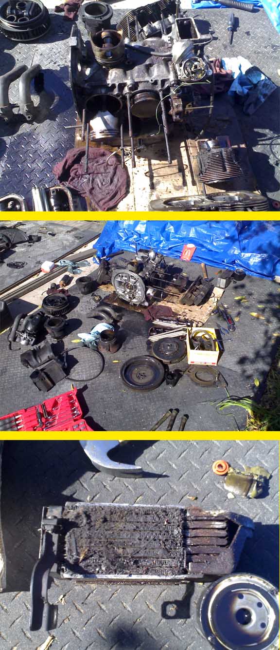

Today I met Mark.. I have never learned so much in one day as I did today. NOW I get it... I may not know it but I do get it.. The engine is coming along and will get cleaned tomorrow. Here are the pics from todays work.

Looks more or less like it doesnt it.. Well, me and mark talked while working on it and I was eager to learn so we just keept taking parts off and he explained very well how and what not etc.. So it will be a "small" rebuild. no new parts just making sure the parts I have is ok to go basically.

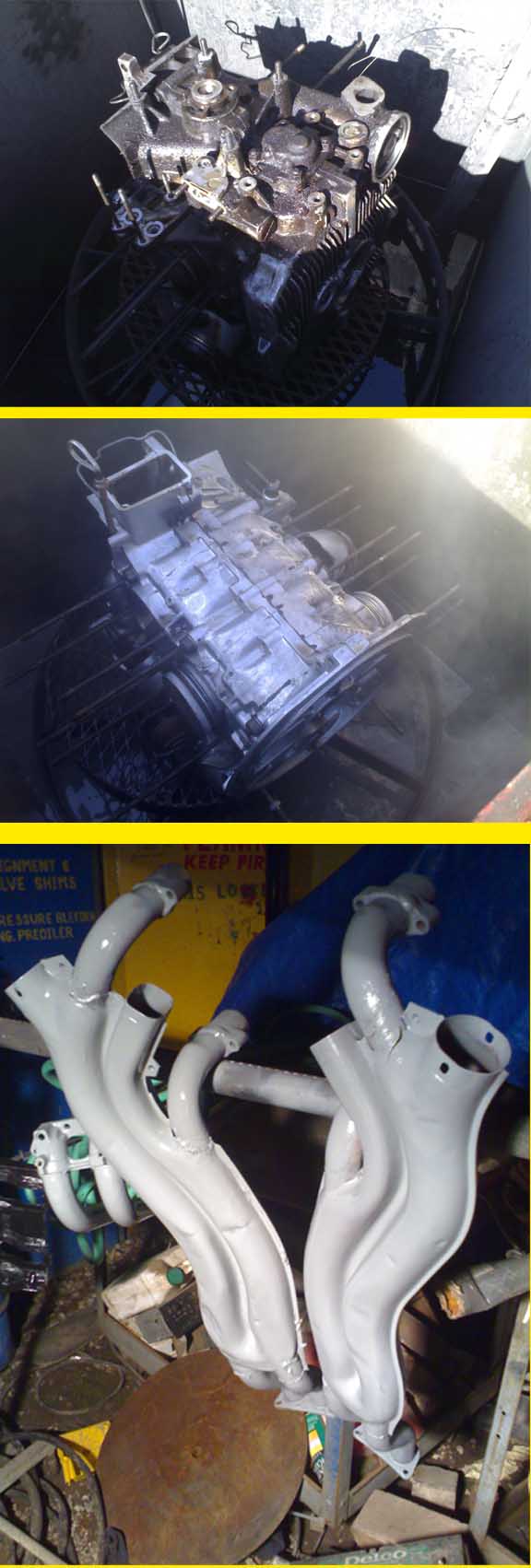

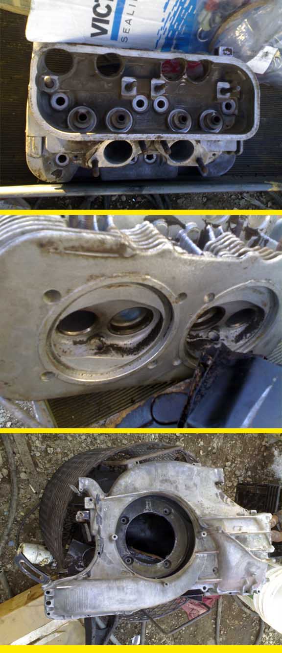

I'm blown away. Mark knows what he is talking about. So I went into this wanting a re seal for my oil leak. Today we almost finished a top end rebuilt. My valves are so shiny after some magic. Look at the difference in the parts from yesterday, today they are sooo clean.
More to come.

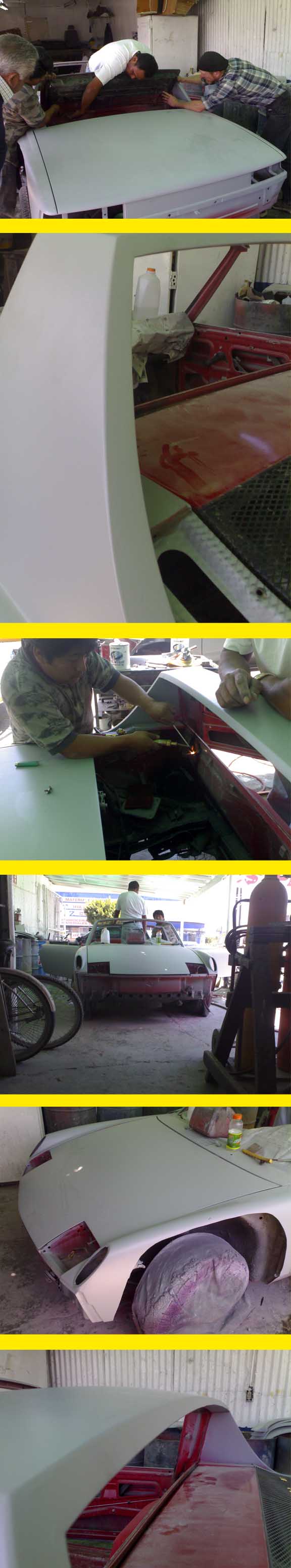

I biked down to our friends on the other side of the boarder today with mark.. Its coming along, the guy who worked on my car was sick for a week, so it is not finished. Closer but not yet there. they say next weekend. However its been next weekend the past three weeks now. Here are todays photos anyway
