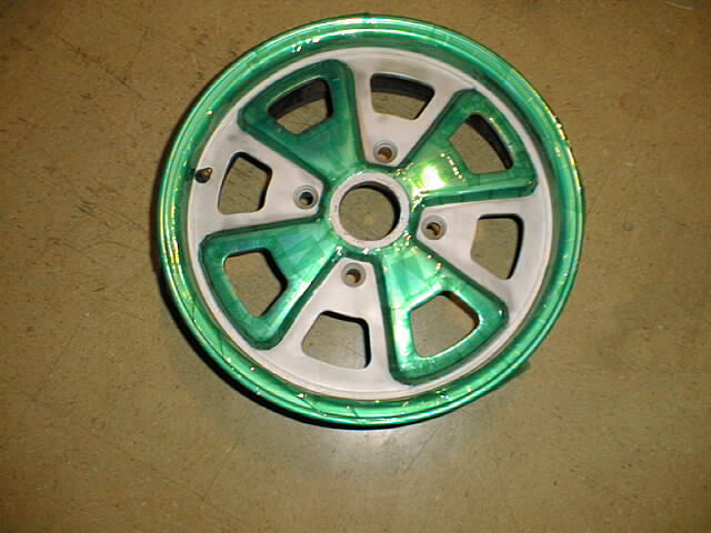

I just got me a powder coating system, I bought the craftsman setup, don't need a compressor to run the gun. I dedided to coat my spare wheel for my spare tire. Never done this before but it seems straight forward and pretty easy. The hardest part is preparing the piece to be coated.
Anyway heres some pics. of the process
The wheel all masked off ready to take some powder

Mueller   damn.....I thought by the 1st picture you powderco...   Feb 13 2006, 03:35 PM

Mueller   so how does the powder get applied w/no compressor...   Feb 13 2006, 03:38 PM
maf914   What kind of masking tape is that? I was surprise...   Feb 13 2006, 03:39 PM
StratPlayer   The gun has its own fan system for blowing the pow...   Feb 13 2006, 03:45 PM
StratPlayer   The masking tape is high temp masking tape from 3M   Feb 13 2006, 03:52 PM
yarin   The most difficult part of setting your system up ...   Feb 13 2006, 03:53 PM
