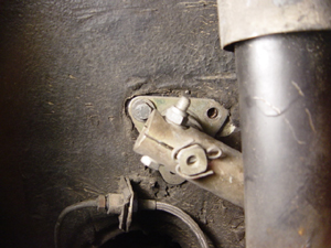

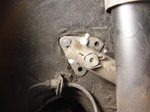

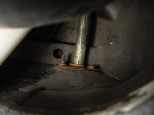

I hope you don't mind but I am going to tag on to this thread with a related question!
I heard a clunking in the front of my 6 yesterday and a shake at 60 mph or above so I took a look at the front and noticed that there was only one bolt holding the sway bar in place. When I pulled the tank out to look at what was going on I found that the inside plate had the bottem nut part removed and only the top two nuts were left. Should I remove the inside plate and replace it with a 3 hole plate?

Hey Jeff,
Yep, get a new inner reinforcement plate
You need to grind a small pice of sheetmetal out of the way (out of the boxed part underneath the plate, which is shown in your first pic)
Also weld then new plate to the chassis
Check the thread on Jenny's car, it shows a couple of pics of the inner plate installed

Jeff,
Looks like someone didn't notch the sheet metal under the tank for the bottom bolt. Does the triangle plate seem to be cut ??
Or, does it come from the factory that way ??
That's what I thought I would have to do!! Bummer!
Yep!! I felt under the bar on the inside and it has been cut! It is also not welded in!!

Jeff... weld a nut back on the plate. Its not a big deal. It will cost you 1$ and welding time. You now they slacked off and didnt want to cut the tub for the bottom bolt.
B

Member No.: 8
Wait.. I dont get it.. (and your pics dont show it) did they cut the bottom of the plate off completely or did they remove the nut ?
