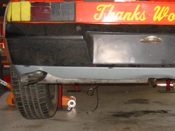

Some mufflers have a center exit with a pipe extending the tailpipe to the side.
I like the idea. The PO of my car did something similar by editing the tail pipe after the muffler. Its not quite perfectly centered, but pretty darn close.
I'm sure anything Chris puts together will be leagues better than this, but here's the best image I have handy that shows mine.
Not quite as nice looking as a Boxster...haha...maybe someday. (IMG:http://www.914world.com/bbs2/html/emoticons/wink.gif)

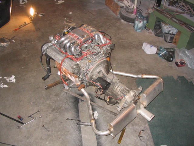

This is what I did. I'm re-doing my system completely this year. It's too restrictive. I'm still going for the center exhaust, (same mufflers facing each other) but I will get mufflers with larger inlets, and large duel outlets. I will use one of the outlets as a cross-over or balance pipe and the other as a combo center outlet. (larger, of course) I plan on adding tubes on both sides of the straight exhaust section for a heat exchanger too. I think there's room. I'm also going to use all mandrel bent curved sections

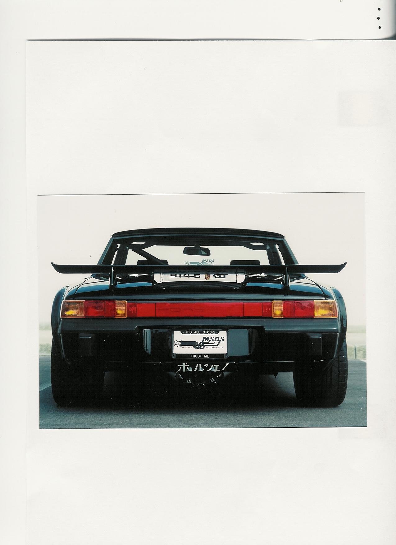

I've always liked the center tips idea. The older 356 Carreras and 550s had them--called Peashooters.
The 935s used them, as did I on the black biturbo. The F40 Ferrari had em too, and now the 986 and Cayman.
Mig welder and mandrel bender= No limits (IMG:http://www.914world.com/bbs2/html/emoticons/idea.gif)

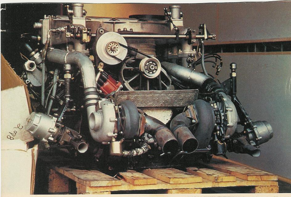

...and
JmuRiz
post Feb 22 2006, 09:43 AM
Posts: 5,628
From: NoVA
Member No.: 50
Sheesh Marty, quit posting pics of that slow POS already, haha.
I noticed you have a 3'rd pipe, like the F40 had, is that for something with the turbos?

Maltese Falcon
post Feb 22 2006, 11:36 PM
Posts: 5,261
Joined: 14-September 04
From: Mulholland SoCal
Member No.: 2,755
Nathan, that's exactly what the smaller center tube is for. I bring the excess exhaust out of the wastegate, down around the transaxle, and dump it to atmosphere in between the other 2.
