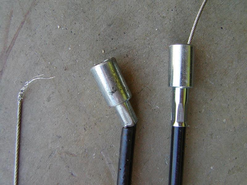

Here is why the original one broke (IMG:http://www.914world.com/bbs2/html/emoticons/ohmy.gif)
Not sure why this happened? I thought I routed things like the factory..
New Terry cable on the right (Broken to)

The one that lasted about a year (on the left) was a OEM or GEMO? type cable. I guess I routed the cable wrong under the engine. It broke at this bend
The one on the right is a Terry Cable and broke in 3 hrs.. Still trying to get my money back.. Working on my second week with PParts on this. (IMG:http://www.914world.com/bbs2/html/emoticons/mad.gif)

I broke my First Terry fairly soon after my SIX conversion in the same place.
The tube that comes out of the firewall for the throttle cable is aimed so the stock FOUR cable can go up and into the engine bay.
I bent the tube so it is aimed back toward the trans and bell crank. This stops the cable from sawwing through the sheathing and fraying 'til snapping.

The Terry Cable broke at the Pedal and not at the bend shown above. The Terry cable pulled out of the threaded end piece (IMG:http://www.914world.com/bbs2/html/emoticons/headbang.gif) ..
