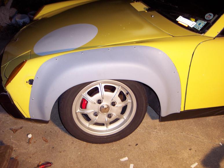

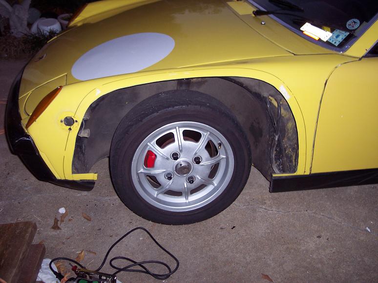

OK here is what I did . sanded primed and fit the flare.
marked all the spots for rivets. 3/4" from edge spaced 5 7/8" apart
Then used double sticky tape and stuck the fender to the car.
marked the layout and position so I could repeat.

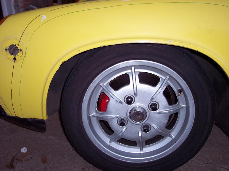

pulled off flare marked 1 1/2 inches in and made a cut line.
Without a single beer I took a deep breath and fired up my Hitachi jig saw with extra fine blade
30 seconds later I had a big ass hole where the fender was.

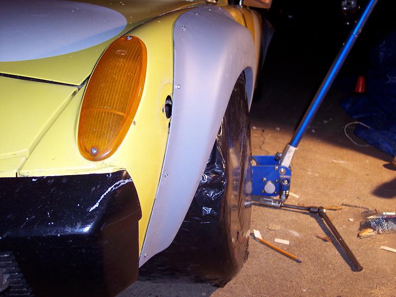

The hole No turning back now

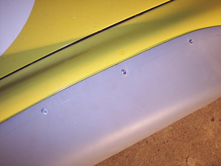

Had to trim here and there on the bottom edges of the car and flare for a good fit

I just have it hanging on with #6 1/2" hex screws pulled up nice and tight all the way around.

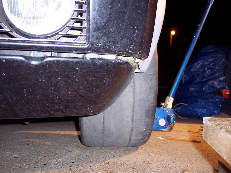

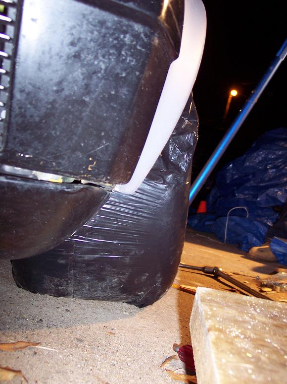

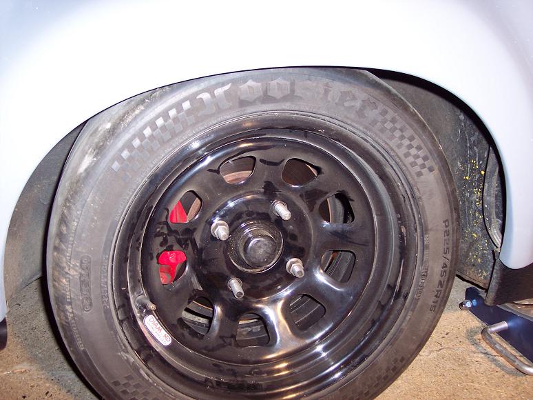

So Paul here ya go to answer the question will the big fatty slicks fit????
I Don't know depends on how much the tire is pinched on the rim.
FYI the tire in the bag is 22 x 9.5 x 15 Hoosier bias ply slick cross section is 12" off the rim.

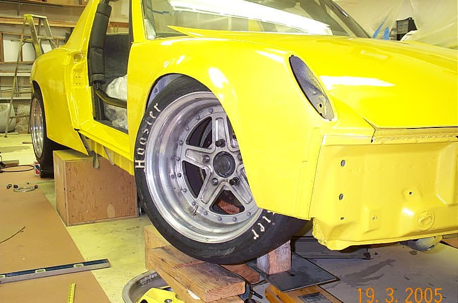

Nuther fatty pic

and for reference here is a 225/45-15 Hoosier on a 15 x 8 Diamond rim with 4.75" backspace. Tons of room

nuther

did you use the "flared rocker panels" as a guide to where to mount your fender flares?
if not, you'll have to use a lot of bondo to make this look right ...
(IMG:style_emoticons/default/cool_shades.gif) Andy

BONDO???????????? (IMG:http://www.914world.com/bbs2/html/emoticons/confused24.gif)
Big fatty pop rivets baby that's why I took such care in laying out where the holes go.
Going to paint the fenders then rivet them on and leave the rivets shiny. and a black piece of beading to trim the edge of the flare.

please weld up your sidemarker hole first....

Yea yea yea. it was dark as crap when I cleaned up. I'll get to it this weekend as the paint drys on the flares.

I have learned that tire numbers have very little meaning to me.
Section width is what matters and I think I pushed it too far with the slicks. Off the rim section width is 12" Hopefully the tire will get pinched in enough to change the section width.

The only place you may run into a problem is with the height of the fender lip.... and that at full (or close to) lock & full suspension compression. I had to raise the fender opening bout 3/4 inch. also had to do some trimming at the back edge of my LE air dam & adjacent fender....which you cut away.....normal rife height was the worst. I had to push the fender out and reweld the support.
It's a PITA to check for the clearance at full compression & lock, but better than tearing up tiars or body work at an AX.

That is pretty much just how I did mine. I used some Cleco fasteners to help hold the flare on while driling additional holes. I also bought a pneumatic riveter at Harbor Freight for $20 since I got tired of squeezing that dammed rivet plier. I learned to put a piece of tape around the rivet area as the rivet tool tends to jump some. I also found it works well to back the inside of the rivet with aluminum rivet washers.
