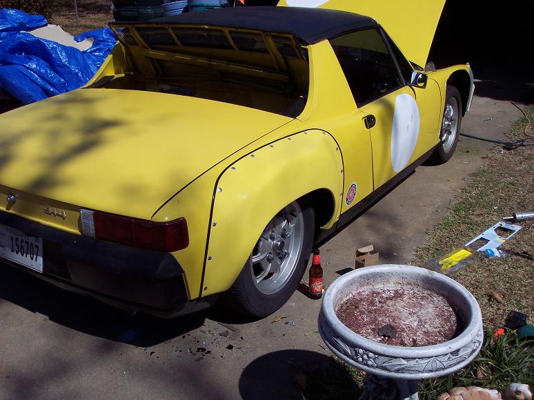

Progress made today rear flares permanently attached I am please with the results
Fronts are ready to go got the side markers welded up primed and painted. Front fenders get riveted Saturday.

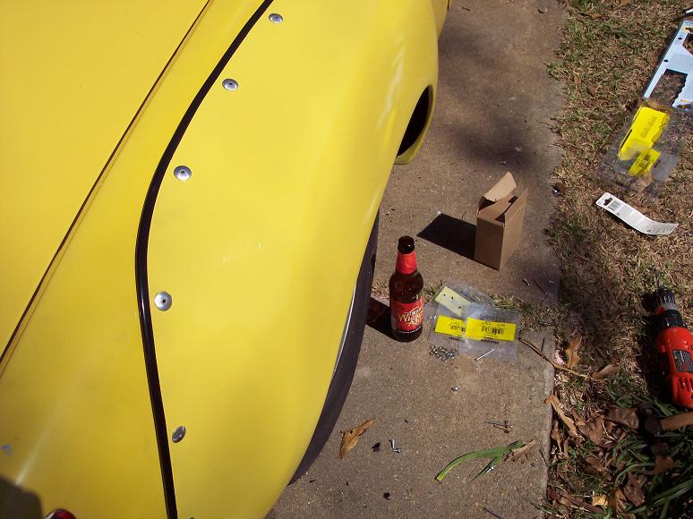

Close up this is EXACTLY what I wanted

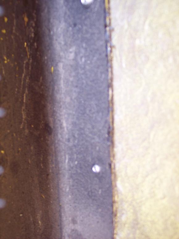

Under side because Rob asked
nice and tight to the edge rivets with backing washer, Great idea John Rodgers. Pretty much a PITA but worth it.

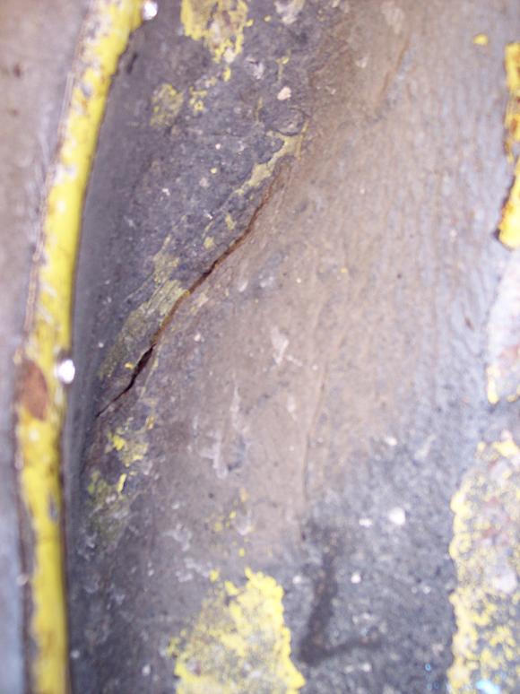

Figures I got the one rivet that didn't get a washer.
Nuther of the under Gee I should scrape al that nasty stuff off and put new in. (IMG:http://www.914world.com/bbs2/html/emoticons/idea.gif)
