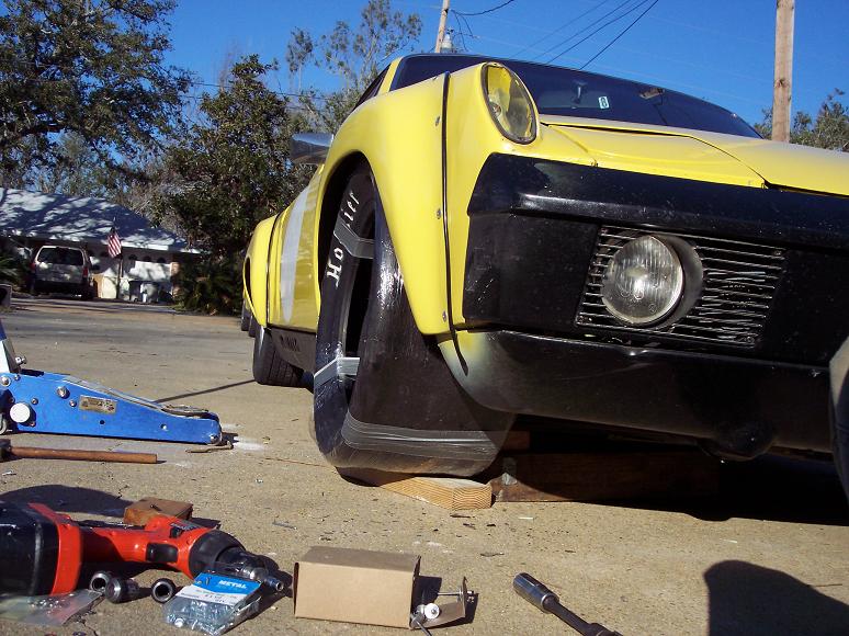

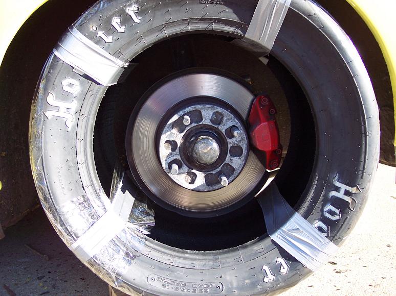

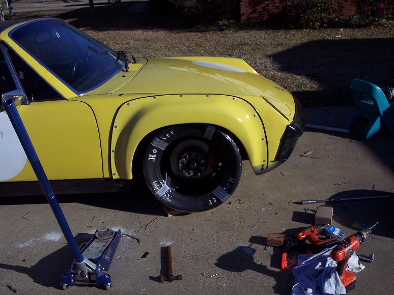

Actually like I said last night maybe if I pinch them down to what the rim will be.
Looks like it made them much skinnier. Tried my best to simulate where the tire sits at ride hieght in relation to the fender. got about an inch total on outside maybe a 1/2 inch to the strut. So if the back spacing is good I should have nothing to worry about. (IMG:http://www.914world.com/bbs2/html/emoticons/biggrin.gif) Rims were measured at 4.75" back space. plus I got a 1/4" spacer to screw around with.
