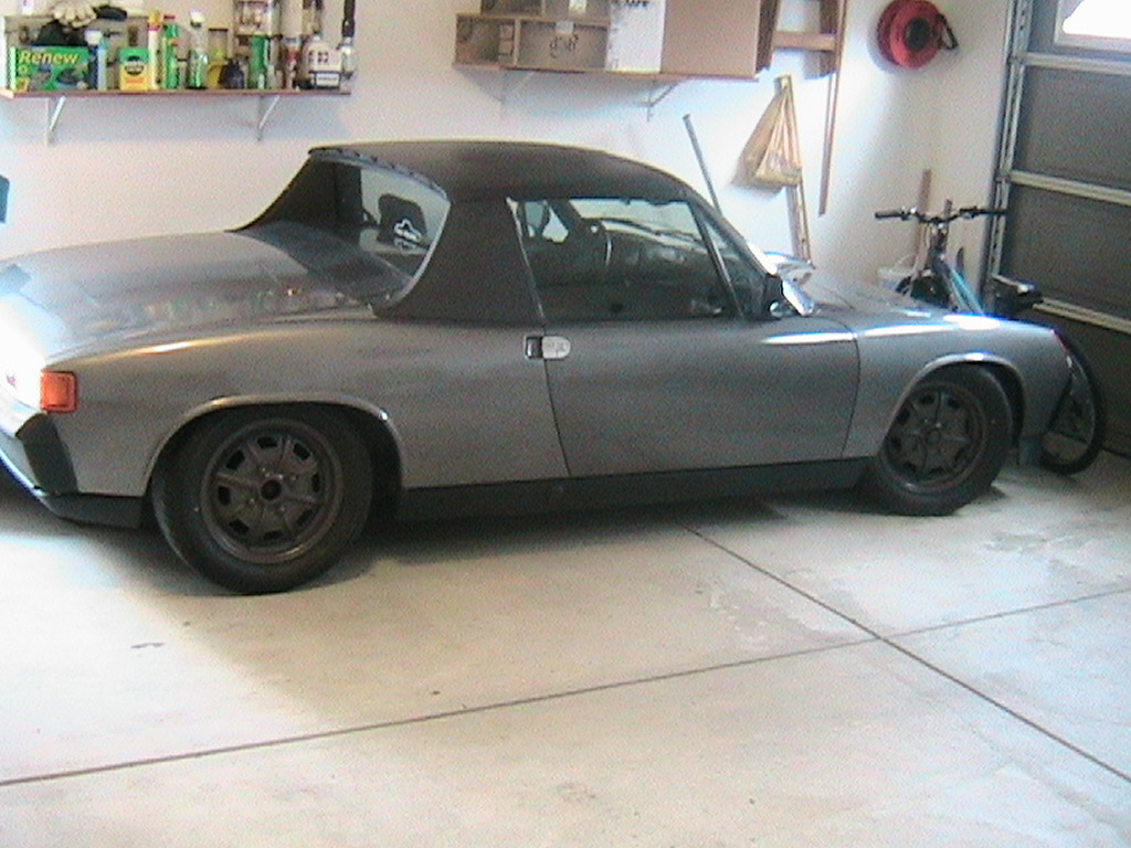

I know the car is running a little fat. The mechanic told me he set it up like that for the break-in.
I had alot more and better pics but I let them get opened and save with some shitty adobe program so they wouldn't post. Here is the only one I have. It was taken 10 minutes ago. Can't go outside because of hail.
