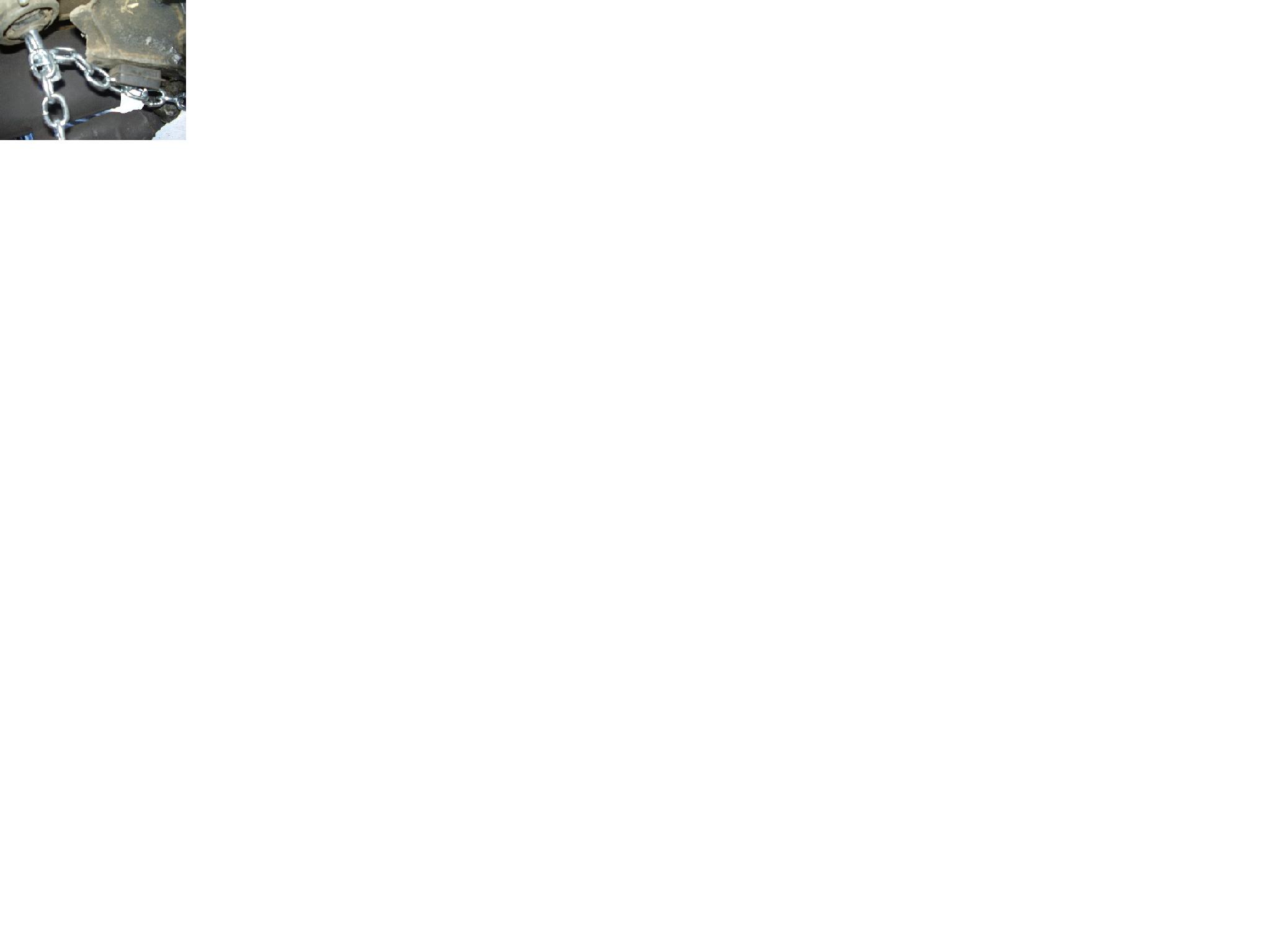

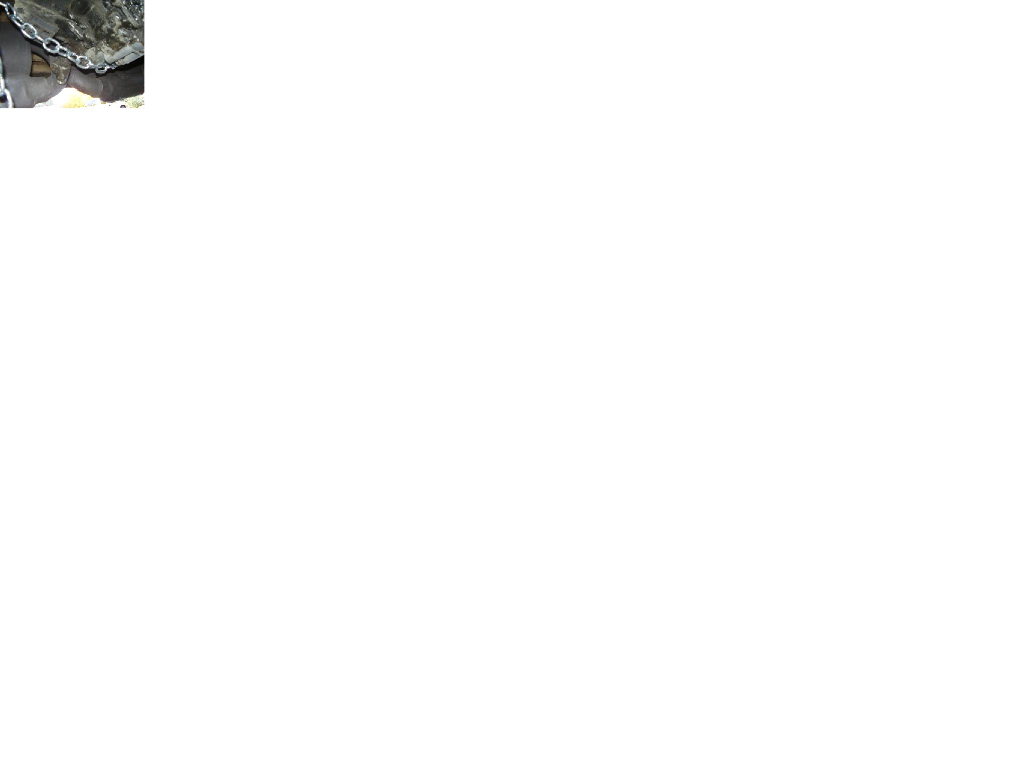

one side broke off. after removing the piece that bolts to the mount , it looks like it has been welded at some point. going over a curb sideways & backwards back in 1982, in california 101 atascadero, did it im sure . cheated death again. fast foward 24 years , time to fix it the right way .question is : how hard is this to accomplish i have some skills and a mcguyver sense. any help is a good thing. my car is a 74 2.2 with a side shifter james( still cant make pictures load , page expires, or an error says cant upload this type of file) its jpeg and im cable modem

my temp. fix

another picture of the temp. fix
Aaron Cox
post Mar 12 2006, 08:59 PM
Professional Tinkerer
Posts: 24,548
Joined: 1-February 03
From: Corona, CA
Member No.: 219
A ) please resize your pics.. or crop em to size....
B ) the trannies are MAGNESIUM and only a professional who is trained can do it.....
C ) swapping out a rear cover is no big deal......
D ) dont drive it like that! get a jack under it.....
itsaporsche914
post Mar 12 2006, 09:09 PM
Posts: 169
Joined: 5-August 05
From: cave creek az.
Member No.: 4,541
a: i'm learning
b:i know
c:great, thanks for the expertise (IMG:http://www.914world.com/bbs2/html/emoticons/biggrin.gif)
d:its back on jacks (IMG:http://www.914world.com/bbs2/html/emoticons/beerchug.gif)
Andyrew
post Mar 13 2006, 03:07 AM
Spooling.... Please wait
Posts: 13,381
Joined: 20-January 03
From: Riverbank, Ca
Member No.: 172
IF its on jacks.. ok.. lol
Have a pro weld it, or get another trani...
Pro welding it would be around 100 bucks, (heck I dont know..)
new trani, 300 bucks...
doubt you'll find just the tail piece for sale..
You decide!
