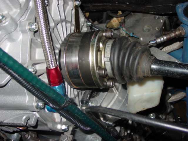

I have a V-8 car running spacers between the inner CVs and the drive flanges. Perhaps because there are two CV gaskets on each side, the bolts loosen all the time. It seems like every time I check them, they are loose! I have drilled the heads of the bolts and plan to safety wire them and maybe use red lock tight. Anyone have any further thoughts about how to keep these little bitches tight? (IMG:http://www.914world.com/bbs2/html/emoticons/confused24.gif)

I have longer bolts that pass through the CV and the spacer into the drive flange. The bolts are loosening all the time and believe safety wire will solve it. Because of the fact that I run a gasket on each side of the spacer (to keep grease from flying everywhere) there is a greater opportunity for the bolts to loosen. The gaskets don't allow a metal to metal contact between the CV & the spacer. An aluminum gasket might be a better material for the gaskets as well.
Bill

The CV joint is relieved for the gasket, which compresses to fill the available space. If the other side of the spacer isn't similarly relieved, there's your problem. The bolts are actually never tight. If you glue, drill, washer, and wire the new bolts, and you don't modify the spacer, you're gonna shear the bolts instead of having them come loose. The Cap'n

I had custom spacers made to the identical dimensions of the CV joints including the stepped down area for the gasket and all. So far, I have only had loosening problems and have never sheared a CV bolt yet...luckily. (And I'm running 500HP)

(IMG:http://www.914world.com/bbs2/html/emoticons/WTF.gif) pic
