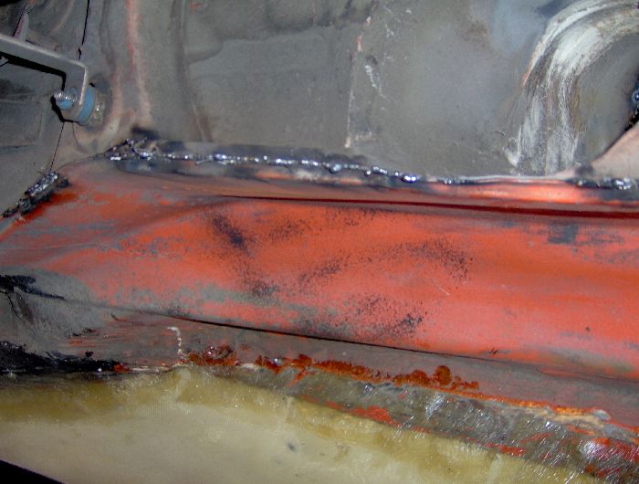

I think seam welding IS a Ton of work, yes for only small gain... but come on.. in racing gain is gain.
- How much money do people spend on 5 hp in racing?
- How much money do people spend on weight in racing?
every little thing helps!
I'm sure tube framing every weak point would produce bigger gain, but its heavier and not always legal.
We spent 2 years prepping our chassis
and then 6 months assembling it.
my thread shows all of the assembly, but doesn't show the 2 years of seam welding and chassis work that went into it......
We seam welded a bunch of it.

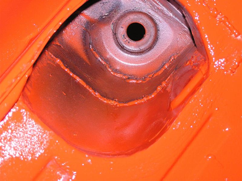

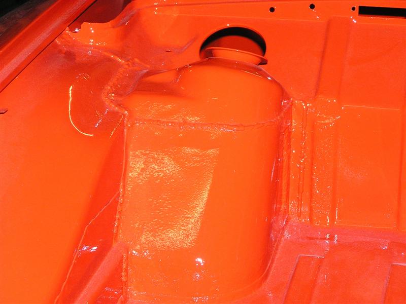

here are a few shots:

Inside of the same:

Brant, Thanks! I was working on that area last night..
PITA to weld... I couldnt get my welder configured right..
Andrew

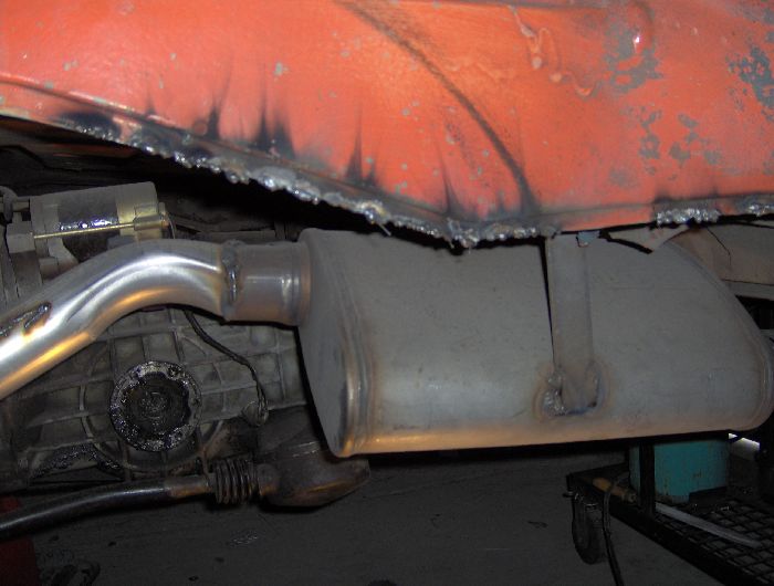

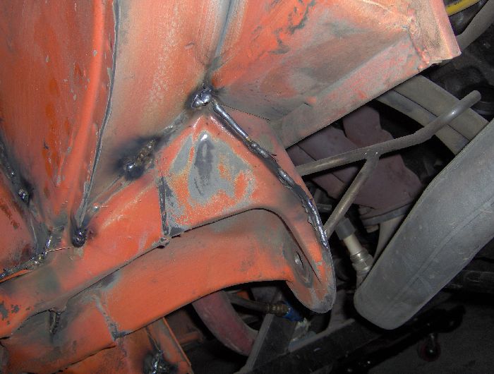

Heres some shots of my crappy welding.
Back of the rear fender.. Not as structural as ahead of it. Figured it was a good place to test.

(IMG:http://www.914world.com/bbs2/html/emoticons/chowtime.gif) yummy! goober welds! (IMG:http://www.914world.com/bbs2/html/emoticons/chowtime.gif)
man, you got MattR'd! (IMG:http://www.914world.com/bbs2/html/emoticons/laugh.gif)
have some fun. a grinder is all you need..... (IMG:http://www.914world.com/bbs2/html/emoticons/smile.gif)

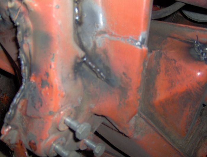

more

Get it dialed in a little... and figure I'll try a little piece.

Smore

Close up of my only line I did.
Rest were done by tacks so I could grind them off if I wanted.

more welds

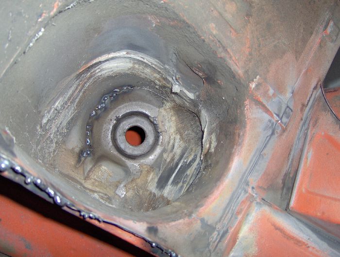

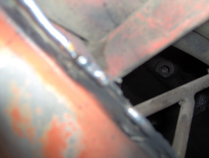

My trouble area..
Couldnt get a clean weld, burnted a little through, played with the settings, Metal felt a lot thinner than the rest.. Sparks would rest on my glove and burn my hand, and hit my shirt, and splatter over my mask... Upside down.. arm fully extended.. Gave up... lol

have you thought about grinding the area you wish to weld first? (IMG:http://www.914world.com/bbs2/html/emoticons/huh.gif)

Yes.. I used a wire wheel.

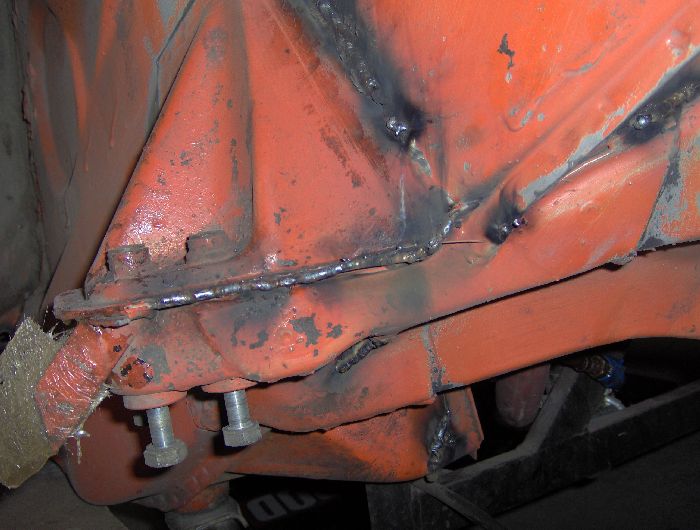

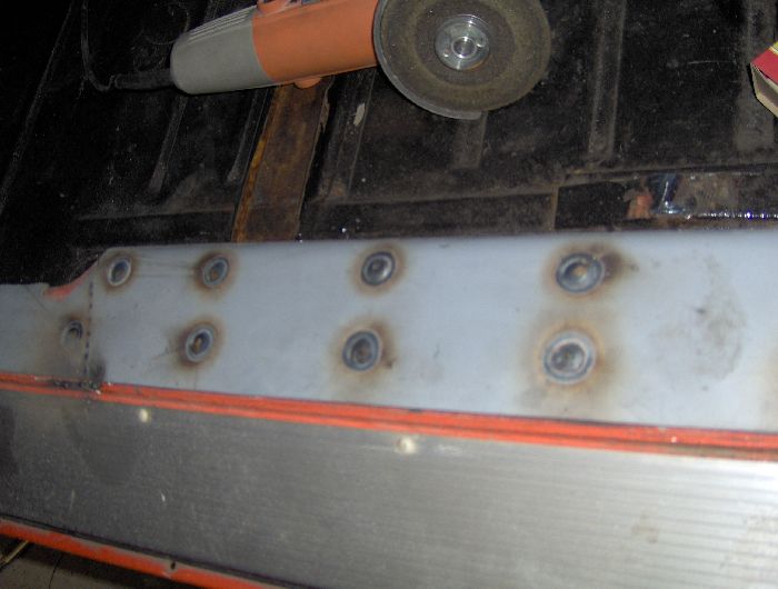

heres my long kit welds.

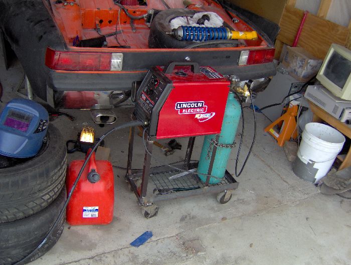

Finally my setup.

Were those done with a spot welding machine?
