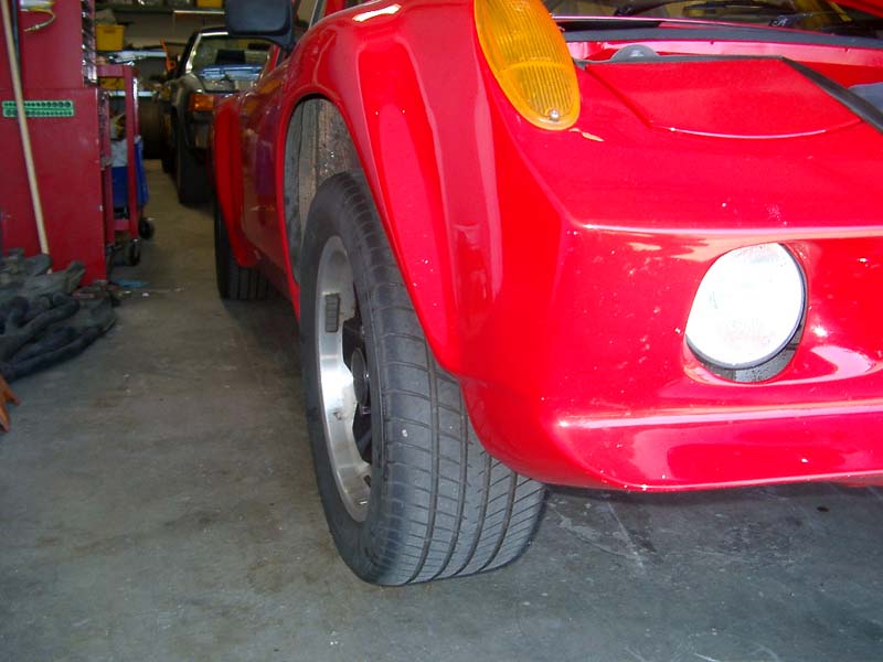

QUOTE (jgara962 @ Mar 22 2006, 04:48 PM)
Anyone have ideas or pictures of what they have done?
stock fog-light mounting point, accessable from underneath. there just enough space between the 916 bumper and the car to get a wrench in there. a bit tricky but doable ...
(IMG:http://www.914world.com/bbs2/html/emoticons/smash.gif) Andy

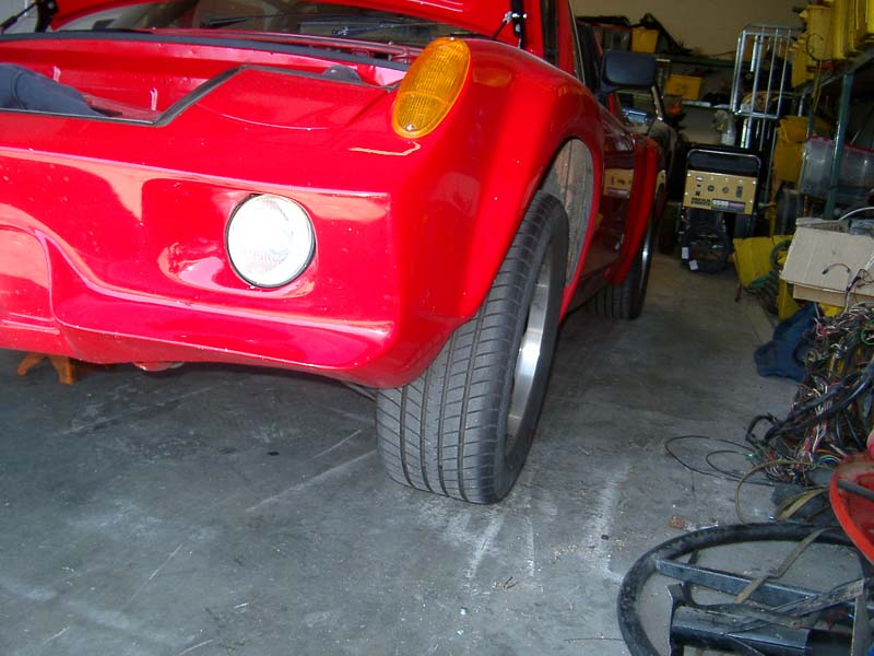

post Mar 22 2006, 08:07 PM
Resident German
Posts: 42,562
Joined: 21-January 03
From: Oakland, Kalifornia
Member No.: 179
other side ...

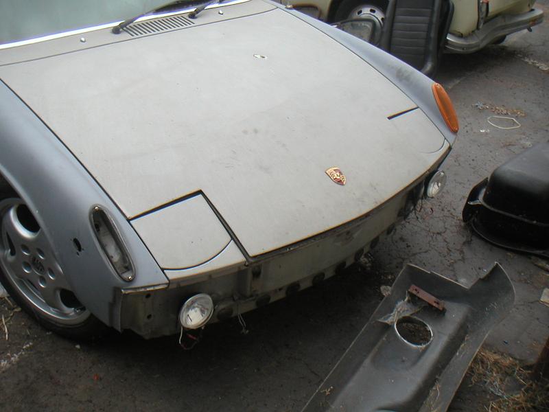

Dr Evil
post Mar 23 2006, 11:56 AM
Send me your transmission!
Posts: 23,044
Joined: 21-November 03
From: Loveland, OH 45140
Member No.: 1,372
You may be able to see the holes for the bolts in this pic
Dr Evil
post Mar 23 2006, 11:57 AM
Posts: 23,044
Member No.: 1,372
Yup, in the pic above look just inboard of the dog bone shapes to the flat spots toward the bottom. The bolts are actually still in there.
Does this help? I can photo shop later, but I am about to start class again.
