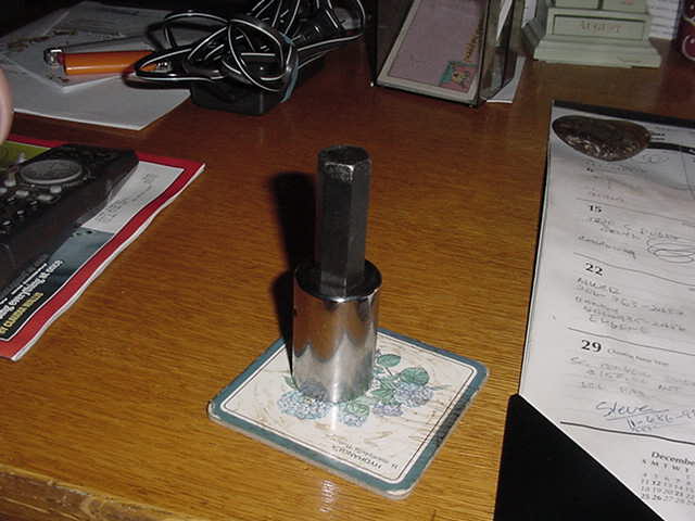

get one of these 17mm beauties. works dandy on your breaker bar.
k
