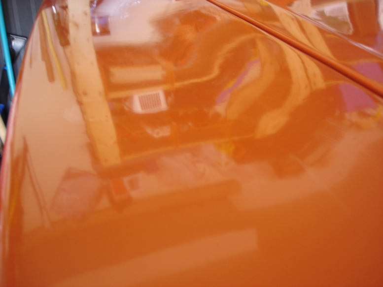

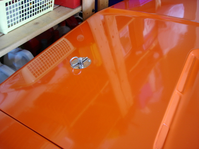

Did you open the link and read the 20+ pages of the thread? Seems like the guy is on to something and others have seen it or done it and agree with him. Attached image(s) ![]() |

These are shots of his car. Not bad I'd say.

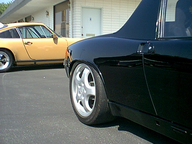

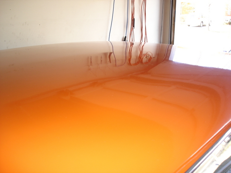

It is a hell of a lot better than the cheap spray job I did on my car.

Sorry Paul... that looks pretty bad to me. (IMG:http://www.914world.com/bbs2/html/emoticons/huh.gif)
Like the previous post... if it looks that bad in pictures, imagine what it looks like in person. 914's are quickly becoming the next classic Porsche. I wouldn't condone that type of behavior. Maybe it's an alternative for a race car... (IMG:http://www.914world.com/bbs2/html/emoticons/confused24.gif) |
