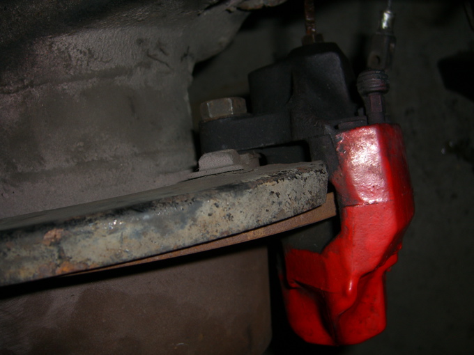

for those of you not following the other thread on this. I decided after much consternation and information gathering. To do it. What was it?
I put my 914-4 front calipers on the rear of my track car.
I have vented SC rotors on the front now with M calipers loaded with Porterfield R-4E track pads.
On the rears I plan on running basic street PBR pads.
I am going to try this at a one day event I am instructing at. If it still has too much rear bias then I am going to install an adjustable bias valve.
Pic of offending piece of equipment.

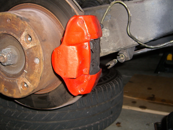

and from the back side

We're gonna find out, me thinks (IMG:http://www.914world.com/bbs2/html/emoticons/laugh.gif)
Personally, I think a adjustable bias valve would be a good plan in any case.....it's more like roullette without bullets. (IMG:http://www.914world.com/bbs2/html/emoticons/huh.gif)

did that setup once and didn't have any problems (on the street) for the few hundred miles I put on the car....used a "T" in place of the prop valve
We tried to tell him that in the other thread but "Mr. Smartypants" had to go his own way! (IMG:http://www.914world.com/bbs2/html/emoticons/biggrin.gif)
I think they'll be OK with the pads but it's hit or miss until or if you get the right combo. I 'really' like the Rear M-Caliper with the spacer removed idea... (IMG:http://www.914world.com/bbs2/html/emoticons/idea.gif)

I know I should have listened to you. (IMG:http://www.914world.com/bbs2/html/emoticons/wink.gif)
I am now looking for a set of rear Ms. May have a line on some.
I just have to try things for myself. Even if .....?
this thread to be updated after my first outing to BW. stay tuned (IMG:http://www.914world.com/bbs2/html/emoticons/smile.gif)

On my last 914 I had M calipers with Hawk Black pads in the front, a 'T' in the line, and the stock 914 front calipers moved to the rear with some generic carbon metallic pads. The bias felt great on the street and track, but I never got a chance to run it aggressively in the rain. That's where bias issues can really show their ugly heads.
