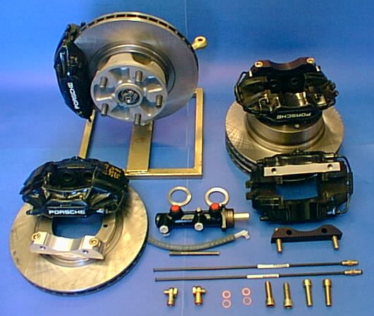

| race914 |
Mar 30 2006, 09:33 AM
#36
73 914-4 ![]() ![]() ![]() Group: Members Posts: 1,006 Joined: 31-October 05 From: Nipomo, California (Central Coast) Member No.: 5,027 Region Association: Central California |
Dan,
Here are the big blacks I had setup for my 914. Another option for 3" spacing. Again I haven't done this yet since the weight loss program has taken away some of the need for bigger brakes. Remember Newland's car? He ran the Alloy S calipers and never had to go bigger... Attached image(s)
