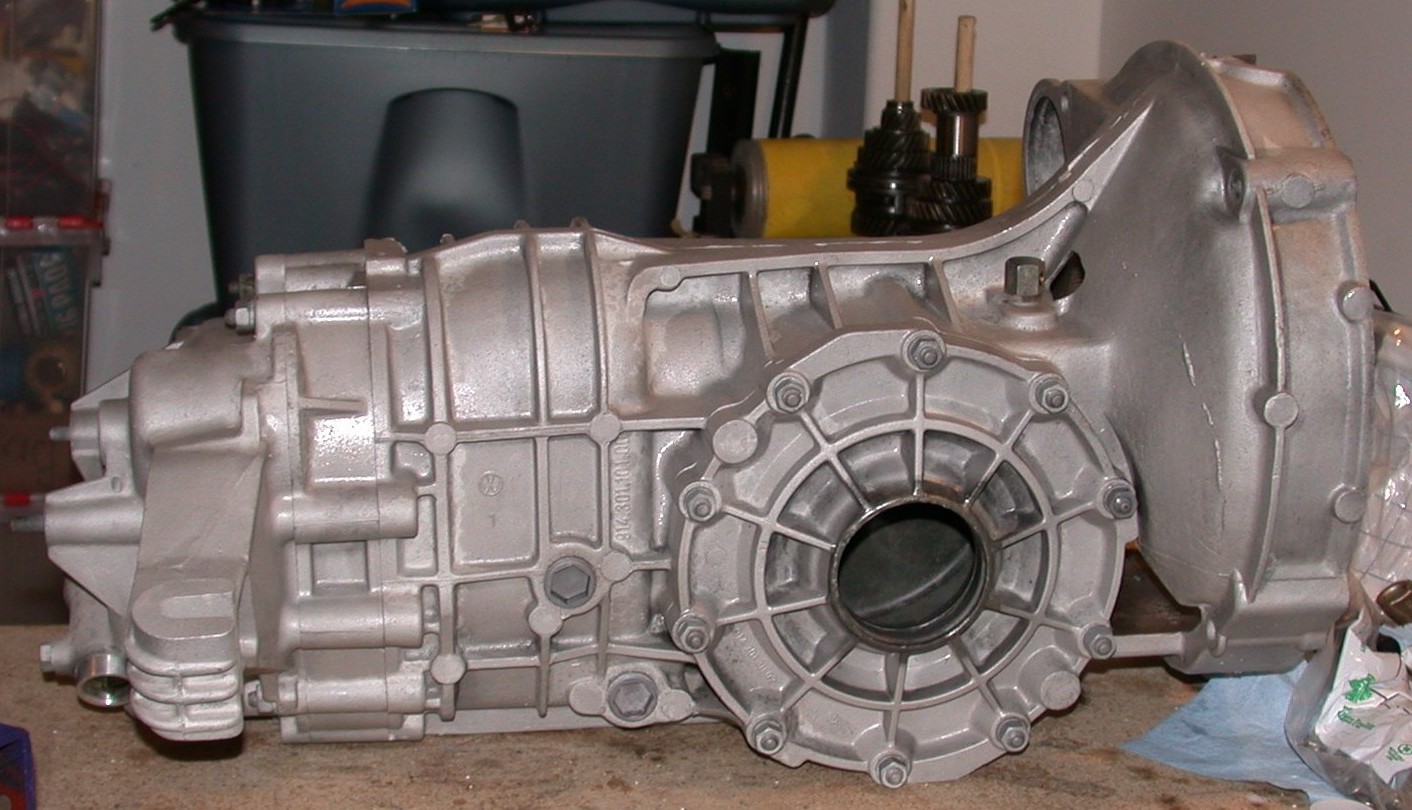

Get it blasted. Here's my case after plastic bead blasting. I couldn't believe the difference.

You need to grind that VW logo off. (IMG:http://www.914world.com/bbs2/html/emoticons/biggrin.gif) (IMG:http://www.914world.com/bbs2/html/emoticons/wink.gif)

Thanks for the input.That pic of your tranny is exactly what i am looking to do.I thought that i would have to paint to get that effect.
I will not paint only clean then blast.
