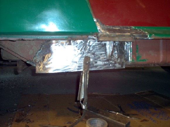

currently fixing same area....but just around the jacking point.

Raymond. is that piece of metal a doubler plate of a replacement for a section you cut out?
I did this to the racer. 16 ga doubler plate with numerous spot welds and seam welds. from the middle of the door all the way back to the suspension console. Wrapped under and matched the last little 3/8" bend at the bottom. I also deleted the jack reciever as I saw it as a week point.

we cut out all the bad stuff around the jacking point. Then plated over the area. Then seam welded. I don't know if that would qualify as a "doubler plate". I not sure of the terminology.
Cutting out the rusted metal and replacing the piece in kind with a butt weld was outta our skill level.
....seems to be working out okay....

Sorry Doubler plate is just that.... double the thickness of the metal. ala. Engman kit for longitudinals. I put spot welds every 4-6 inches to bond the plate to the original body panel.
Ship repair terminology (IMG:http://www.914world.com/bbs2/html/emoticons/wink.gif)

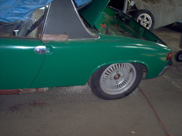

Working on it now.....I just put one side of the car on jack stands. We were a little concerned of the stuctural integrity. Didn't want to do more damage than that was there.
I hope I'm not screwing up the suspension on the other side. See pic below.
