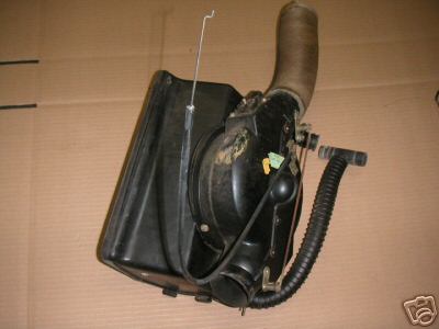

Saw this on E-bay and wondered if it would fit my '74 2.0 (No AC). Currently, I have a squirrel cage blower that looks like it came from a Grainger catalog and was grafted into place. The current blower only supplies one side and will not be acceptable this coming winter.
The Ebay item is listed as a "PORSCHE 914 A/C HEATER BOX BLOWER FAN MOTOR" out of a '72. Current bid is $10.

That's the fresh air fan that's up front under the cowl. It has nothing to do with heat. The heater blower is in the engine compartment, and I suspect what you have is stock, because that's a pretty good description of it. (IMG:http://www.914world.com/bbs2/html/emoticons/smile.gif)
There is an optional splitter that allows you to fit two hoses to the stock one and feed both sides, or you can find an early 2 output fan and use it. (early one mounts to the fan shroud)

a single outlet fan should work just fine for you. prefered acutally as your car will(should) have a bracket on the dr side engine shelve to attach it to. if the rest of your heating system (heat exchangers and related duct work)is in good shape, a single outlet fan, one of the stock flex hoses, the passenger side j-tube capped tightly, and solid hoses that run from the warm air elbows to the chassis, you will have plenty of hot air.
