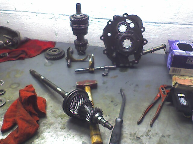

Prior owner, Jim Chambers, had MSX gears for autocrossing. Car is quick, but it made it trying to be on the interstate. I decided to put the standard Z gear in for 5th. This work is being done by Tab Tanner at Autobahn Garage in Findlay Ohio. Here we are aligning the engine/jack fitting.

got the engine out in less than an hour and separated the transmission.

I didn't think we'd get it back together.

we changed one of the shifting forks, too, as one looked and felt loose/worn. it would sometimes not shift into third. hope this solves that problem.

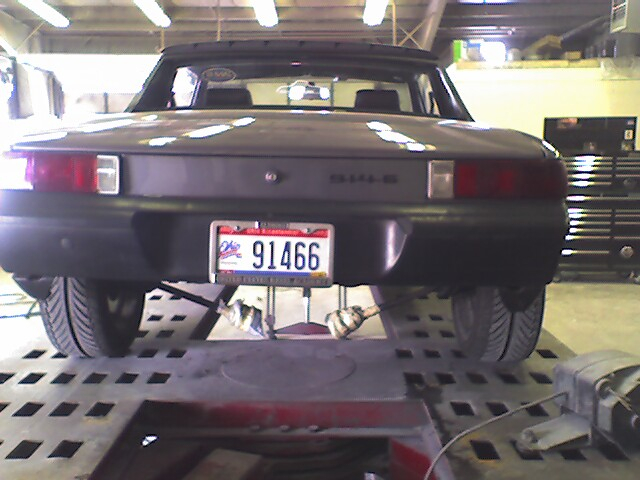

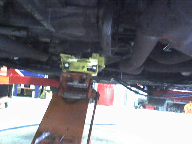

SOOOOO, as long as the engine is out, we get to looking at the rear suspension. terrible creaking noise and the right rear tire is out about an inch more than the left one. can see where the car was hit and it bent the rear suspension. measurements confirm. So, it is going to a place that has a frame rack and computer. They say they can get it back to within a millemeter or two.

I was surprised that they immediately called up the details for a 914. I hope this works and that we get everything put back together in time for the drive over to Hershey.

it is at a normal body/frame shop. they use a computer and lasers. they put reflective pieces at prescribed places. i haven't seen it done, but they use chains and jacks to push/pull it to where it is supposed to be. we could see the hit in the right rear frame, forward of the suspension point, and see how it resulted in a push out of the suspension itself. they assure me they can put it back where it belongs. i'll let you know.

this is very interesting. are the unibody corrections made with the rear control arms and front suspension in place? your car must have gone thru some fuel on the interstate.
