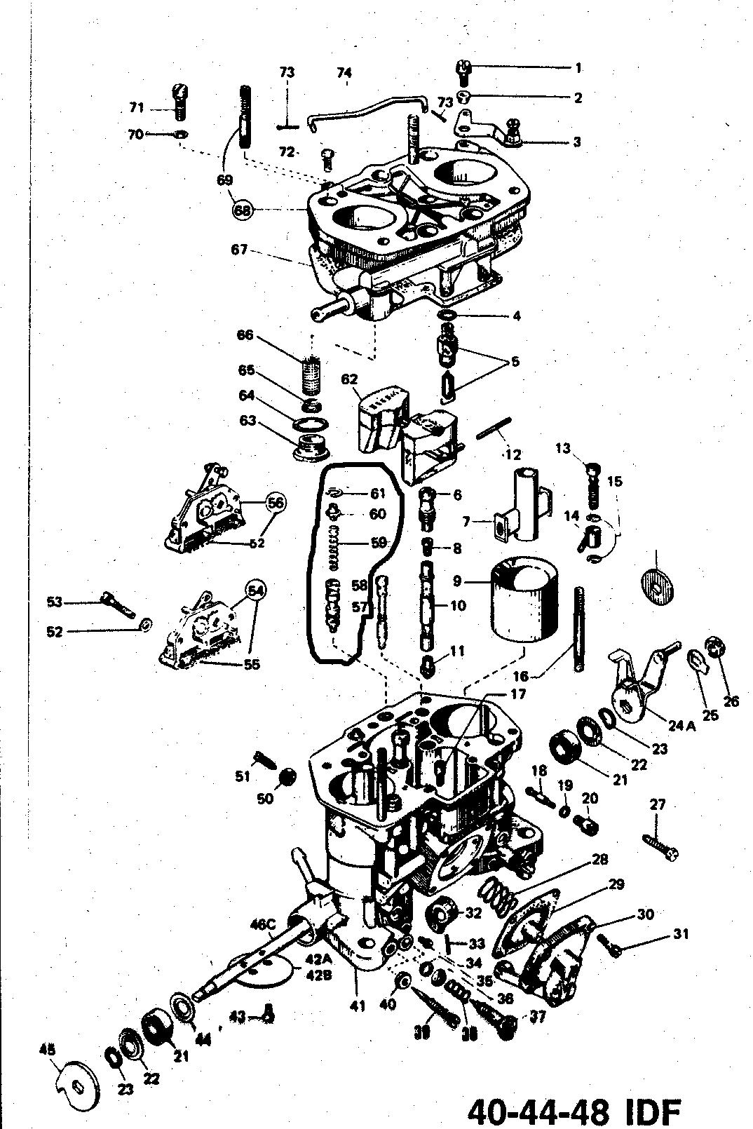

everyone said when you remove the choke/fuel enrichment circuit, you pull the 2 little springed psitons inside...
WRONG. there are like 15 types of IDF's, and if yours came with chokes, all the choke passages are drilled.....
i need this part badly! my car was a fuel pump.... must have been 1:1 AFR.......
oil change here we come.....
I NEED THIS PART BY SATURDAY !!! PLEASE HELP! ANYONE HAVE PARTS CARBS????
I Mostly just need the "spring clip" at the top, but will take it all if you got it.

r_towle   I have it. Show me the exact part. Or tell me th...   Apr 8 2006, 07:48 PM
Aaron Cox   i really need at least 1 #61.... and the springs....   Apr 8 2006, 08:03 PM
r_towle   I have two parts 44 IDF Carbs... Is it the same p...   Apr 8 2006, 08:08 PM

craig downs   Hey Aaron I got some 40 IDF around that have the ...   Apr 8 2006, 11:33 PM
rhodyguy   interesting aaron. is there no way to undo the pas...   Apr 8 2006, 11:39 PM
Aaron Cox   <...   Apr 8 2006, 11:41 PM
rhodyguy   can you post some pictures of 54 thru 61? i've...   Apr 8 2006, 11:43 PM
rhodyguy   plugs=cover plates and pistons=leave the assem in ...   Apr 8 2006, 11:45 PM
Aaron Cox   <...   Apr 8 2006, 11:50 PM
craig downs   I just removed the top off and they are there. If ...   Apr 9 2006, 12:08 AM
morphenspectra   these parts   Apr 9 2006, 12:28 AM
Twystd1   YUP... Exactly what Morphenspectra shows on the ab...   Apr 9 2006, 02:08 AM
