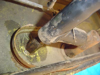

Hi all. So I'm (trying to) drop my engine and it has a tail shifter tranny. My problem is I can't get it disconnected at the front of the linkage. Everything i've seen is for a sideshifter, and it looks different than this. 'Course that could be me! i think i need to loosen the big bolt - pivot bolt right? but it is not moving....am i doing the right thing? appreciate your help & patience as this is my first major 914 surgery!! (IMG:style_emoticons/default/headbang.gif)

i went and dug through my stash and found the shifter bar, you do unscrew the bolt that you thought. take it all the way out or loose, then pull it off linkage coming from cab.

Thanks! That's what I was afraid of. Guess its time for a bigger wrench, cause that baby ain't moving!

Yep thats how you do it. I ran into the same problem last weekend. Throught I was going crazy looking at the pictures on pelicans site and then at my situation and nothing matched. It took some doing but the bolt eventually turned and the engine came out without much more problem

I have done this to many times. Yes he is correct but you will need to remove that
bolt all the way and slip it into the shift bar so it is out of the way. the rest is easy.
Note: Remember lefty loosey - righty tighty. Counter clock-wise on that bolt. Use a long open end wrench
and tap it at the bottem with a rubber mallet.

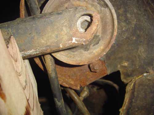

hey i got the pivot bolt out - bigger wrench never fails! but now.... this is the the engine mount - any suggestions how to get it open enough to get the allen in there? i was thinking dremmel tool, or a hammer?

aren't you going back with side shifter? if so use a grinder to open up the passage way. if not do it any ways, i have a tailshift bar you can have.

thanks for the offer, yes i'm going back to the side shifter...but i think i did a bad job explaining - this is the engine mount bar that's tweaked - thats different right? a grinder still may be the way to go, cause i'm putting this in the other car so i can use that bar right?

i guess i don't know exactly what your doing, but i believe your changing this engine/trans to side shifter, therefore it takes a differant engine mounting bar. meaning you can destroy that one. if your planning on putting the tail shifter in another car then you will still need that bar. either way if you destroy it and still need one i have 1.

Put a carbide tip in a dremel and just open up the hole again. No need to grind it until it's junk. (IMG:style_emoticons/default/smoke.gif)

looks like you are fighting a bunch of rusty fasteners. get some pb blaster and spray the stuff down. it will make the job much easier.

I had to cut the engin mount bolt on mine as it was rusted solid. Took forever with just a bare hack saw blade but it's out now.
