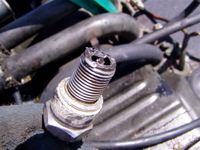

My car has starting to run a little rough last week. Today is is totally down. It acts like it is running on 2 cylinders and won't idle. The points were pitted so I replaced them with the cap and condensor. The plugs were black. 2 were totally wet (3 + 4) and have been replaced. I have changed the ECU, MPS. and the coil. The fuel pressure is up around 29. Any suggestions?

Bartlett 914   Thanks for the input guys. I am still having prob...   May 8 2006, 05:11 PM
Bartlett 914   I think I found something. #1 110 #2 110 #3 0 #4 ...   May 8 2006, 05:43 PM
Bartlett 914   I am so Bummed! I cannot get any clearance on ...   May 8 2006, 07:49 PM
