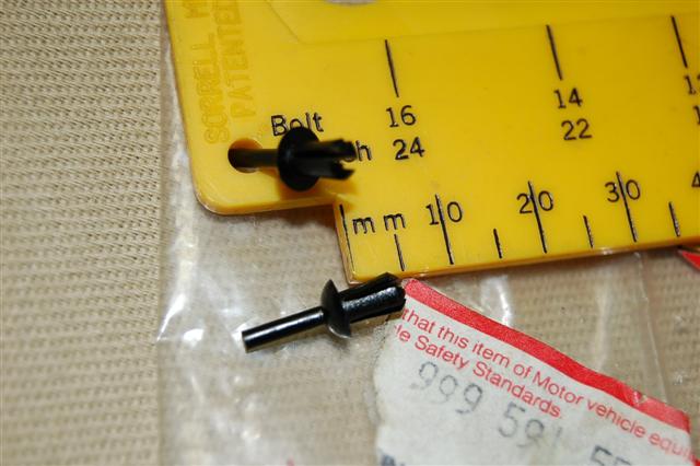

BTW guys,
Here's a picture of black rivets for the rockers. I posted once before & here's another pic. They are a bugger to install because when you push the pin they have a tendency to bend. I believe the factory probably had a special tool to install. Don't know how many I damaged when installing mine with damaged ones thrown in the garbage can. I should have kept them. I believe I paid $1.25 each about (8) years ago. Now NLA. I have a few left if someone wants to use as samples to find replacements???? Pat???? or ???? Tom Attached image(s)

914 Wiring Harnesses & Beekeeper ![]() ![]() ![]() ![]() ![]() Group: Members Posts: 9,267 Joined: 7-January 03 From: San Ramon CA Member No.: 104 Region Association: None
I heard that these were available at NAPA auto parts. The black ones.

Jeff & Pat
I'll send both you guys a sample (East Coast & West Coast). I have Jeff's address but need Pat's. Pat, send me your address to my personal email tjbliznik@ameritech.net Tom |
