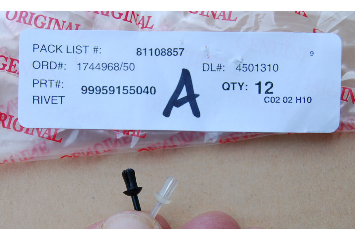

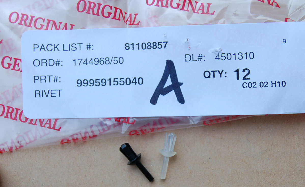

Today I picked up the rivets ordered from the Porsche dealer. I expected them to be black, but they are clear. Now what?? How do we judge rivets now that Porsche only supply's clear????

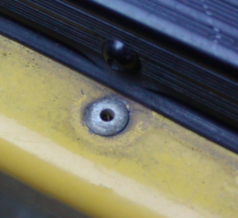

Here are my 100% original 74 Bumblebee rivets, the day I picked it up. Black plastic on the threshold plate, aluminum for the side valence. I bought it from the son of the original owner, he confirmed that the side valences had never been removed until I removed them to inspect the car before purchase. The car was from dry SoCal and the longs are pristine...whew...!

I went through this 3 years ago. I was told by a Porsche Parts personnel that black is NLA and was superceeded by clear. I was surprised to hear that there "were" black in stock @ .80 per. It was suggested to me that dying the clear ones might be an option. I'll see how they turn out with a permanent ink marker if the vendors fail to come up with a match.

I'm with Tod. That was my experience 8 years ago doing my resto. After install, The rivets look like white anyway.
Jeff has the best info on an original LE for '74 even if my '74 parts manual says "plastic rivets" on the rocker panels.
And I agree with you Pat that I wouldn't gig any car with the latest Porsche replacement part.
I'm satisfied with the findings. Confirms my suspicions for many years. The '74 was the change over year.

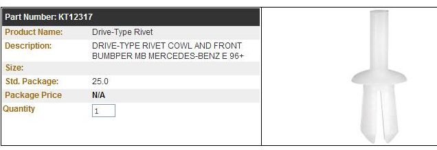

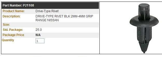

Here are two rivets I found that might be good matches:

Jeff that kt12317 looks like a perfect match.. it's just a matter of sizing. Im still waiting on my samples to show up. I'll post all the info once I get them and see how well they match.

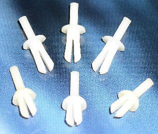

Ok guys I got a perfect match for the black. The white ones she sent are semi translucent white (midway between the Porsche clear and Porsche nla white ones ). So, I asked her to see if they have pure white or whats involved in a production run of pure white (costs & quanity). I'm waiting on pricing from her. Maybe a bulk buy would be a better rate for us, and I can compile 1 order and then mail them out. Let's see what she says. I will call her tomorrow.
