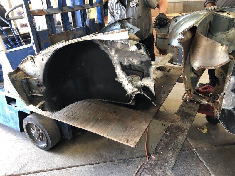

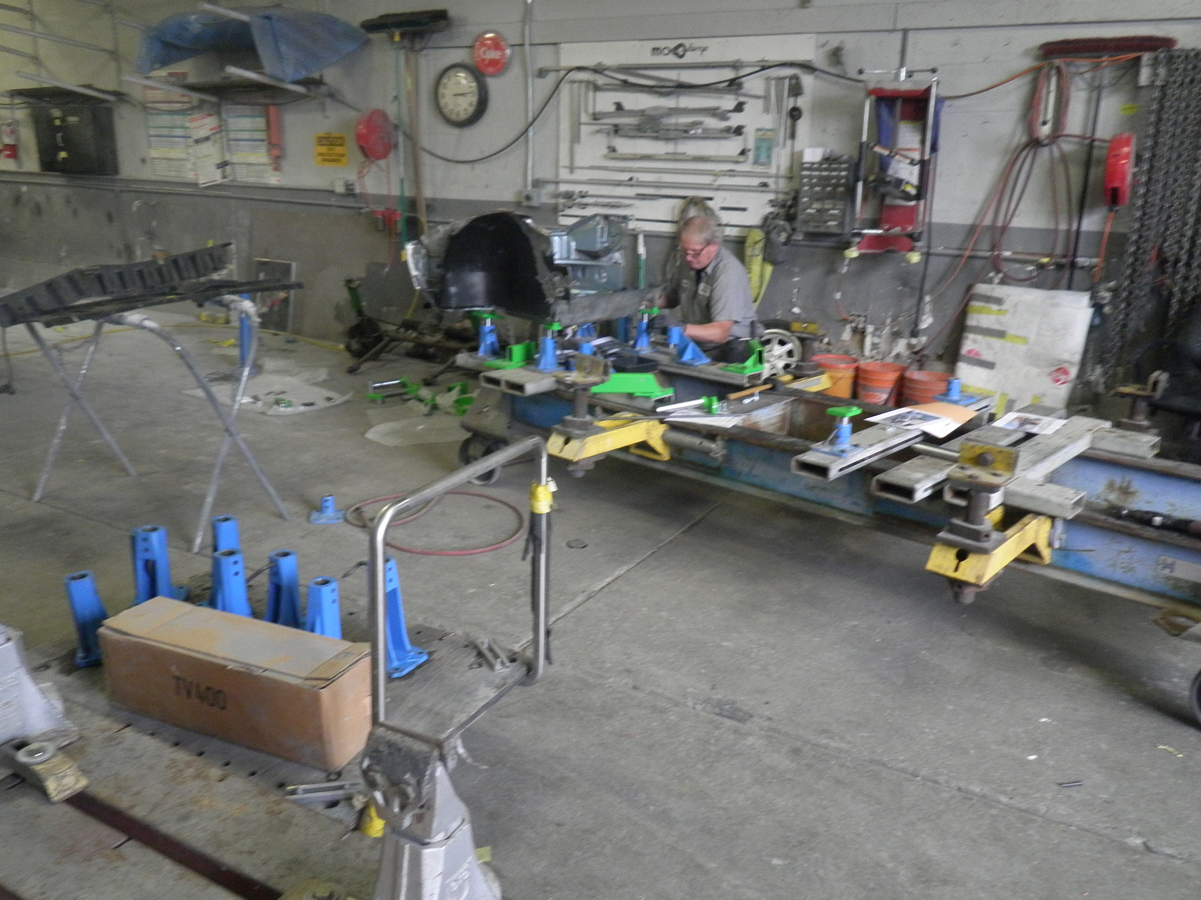

Some progress photos while I was gone. The repair car is still not benched on the Celette.
JMDAZED

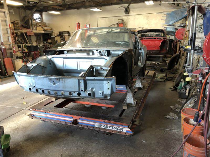

More progress.
JMDAZED

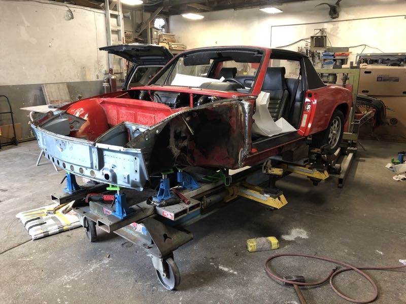

The donor car has donated.
JMDAZED

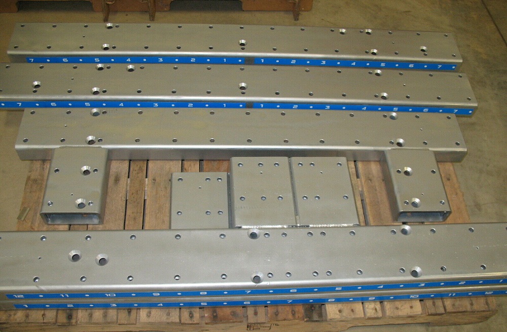

I thought that I may need the Celette cross beams too but didn't want to spend more money if they wouldn't work. That's why I'm asking for someone that may have a set for measurements to confirm the fitment. If it is what I need that so be it but need to make sure that's the case. There's not much info out there that really clarifies that issue. The BlackHawk bench has no threaded holes but just drilled holes all the way down both sides of the I-beams. One big thing that I noticed is that the Celette bench has a large flat piece towards the front of their bench. The BlackHawk bench does not have this piece which is needed to mount the two front A-arm mounts and the Celette cross beam which holds the fixtures for the strut/cross member fixtures.
I'll post a few pics of what I mean soon.
I believe these are the cross beams that I may need. I still need to verify that.

See the countersunk holes. Those are the holes used to bolt the crossmembers to the bench. I can't find my metric tape. It is still packed from the move. But check to see if you have holes in your bench that measure 33 3/8 center to center. There are other holes fro mounting the cross members but these are commonly used.

Rick,
I got 33 3/4'' center to center on the side to side. Down each I-beam is holes 1/2'' in diameter that are 4'' apart. I don't think the Celette adapter plates will work either as the have the same 4'' x 4'' spacing as the BlackHawk units. So not sure what to use.
I believe that the Celette cross beams I posted a pic of is for the newer style Celette bases and not the Celette fixtures that I have. The fixtures that I have would mount right to the bench like the pic that Andy posted. I may have to just modify my bench to mount these fixtures.

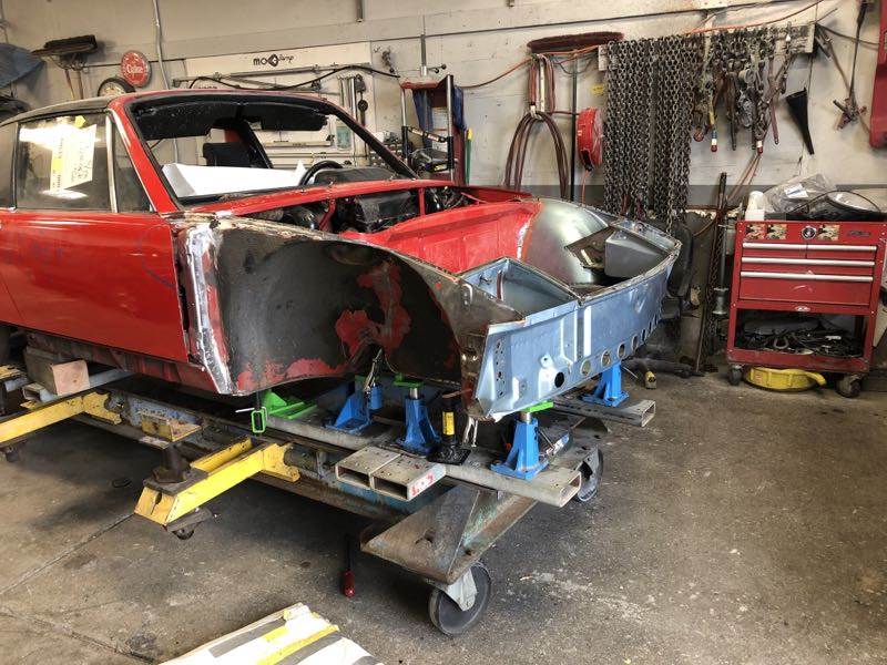

update
JMDAZED

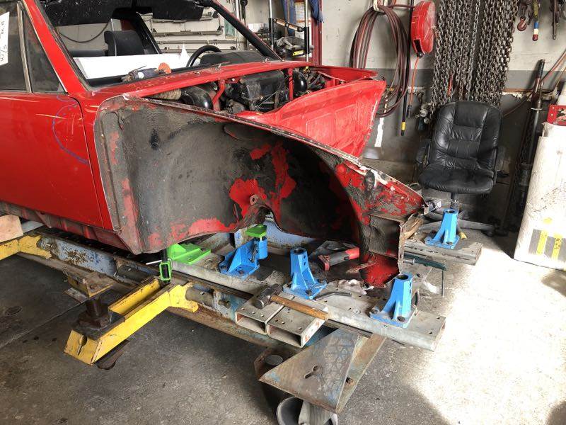

the front is lined up where it should be.
JMDAZED

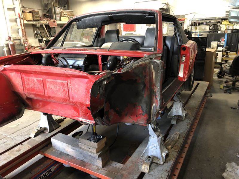

Lots of welding the next couple days.
