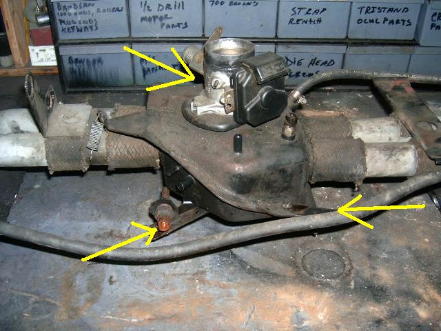

Here's a pic that "MAY" help. It is 3 bolts like Dave said. If you pull the throttle body off of the plenumn you'll need a new gasket and they are nla BUT, I took my throttle body to the local vw parts house here in town and they were able to fit it with one off of a t-1 that only required a little cutting.

Thanks Allan for taking the time for the photo. Answers my question (IMG:style_emoticons/default/smile.gif)

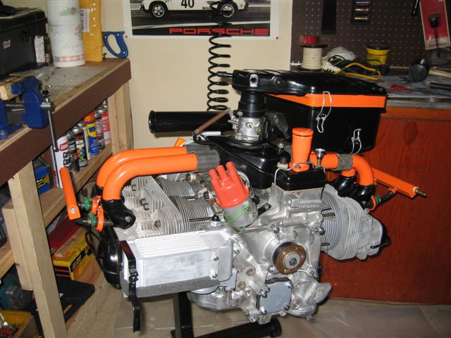

The 2 bolts on the top of the plentium are they competely necessary for a proper install. I have the plentium mounted as a preassembly of the motor. The is no where on this case for the bolts to thread into, I have the other 3 connecting points connected. Just wondering about the 2 long bolts that fit into the top of the plentium.
